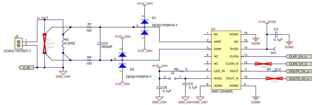

We use AMC1305 as a current sensing by the circuit from tidu499a (http://www.ti.com/lit/ug/tidu499a/tidu499a.pdf)  Figure 21.

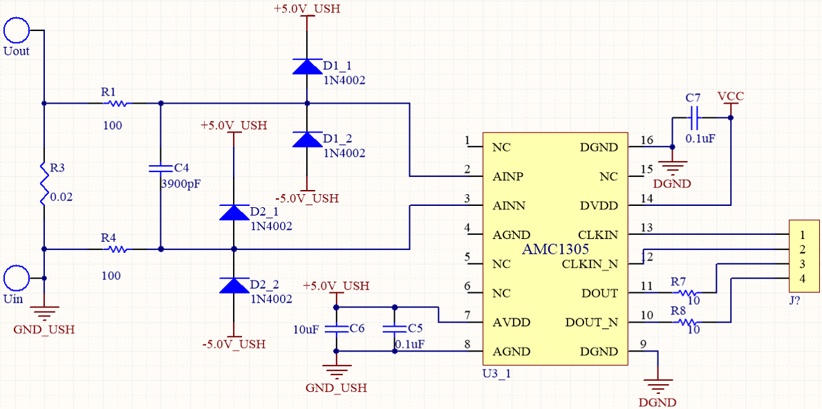

Here is our implement circuit:

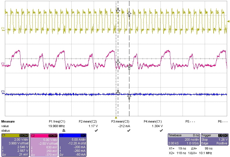

The DOUT of the AMC1305 before connect to FPGA Development Kit (CH1:CLKIN=20MHz, CH2:DOUT of the AMC1305)

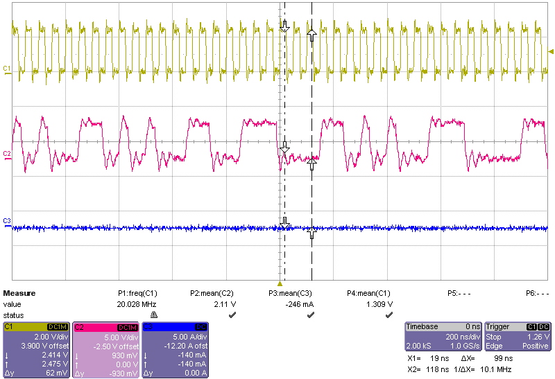

The DOUT of the AMC1305 after connect to FPGA Development Kit (CH1:CLKIN=20MHz, CH2:DOUT of the AMC1305)
Why the data output changed?
Will this influence  the data read by FPGA?

  • Hi user4185739,
    What FPGA kit are you using?  The DOUT of the AMC1305 seems to be getting loaded down by something - it looks like there might be a large R/C in series or perhaps it's caused by a port setting on the FPGA I/O pins.  I'm not sure what the issue might be with the Verilog code you refer to in the post, but you can look through the SBAA094 reference in TIDU499 which also points to decimation filter code.
