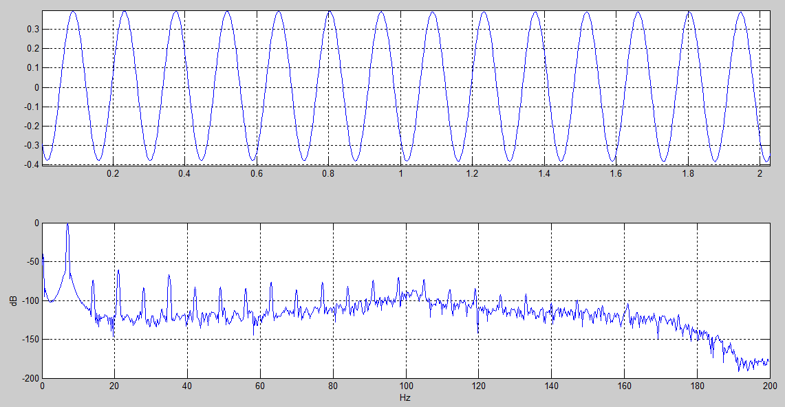

Dear All,
we have designed a PCB based on the ADS1278 working in modulator mode. CLK is fed with 8,192 MHz and the low speed mode Mode[1:0] = 11, CLKDIV = 0. The decimation (5th order CIC followed by a 3 stage FIR) is done externally in the DSP. In the attached example the 1,024 MHz input stream is decimated down to 400 Hz and the input signal is 7 Hz-sinus. Unfortunately, we observe heavy harmonics in the FFT that  we cannot explain. The input is driven differentially centered at 2.5V and is very clean. Likewise, the REFIN is very clean, too. Obviously, there is a strong non-linearity geoverning the measurement. This not obvious in the time signal but dominnat in the FFT. Having verified the analog input and the digital processing, I was wondering whether we are oeprating the device out od spec. Does anyone have an idea where this non-linearity in modulator output is coming from?

    It seems like you are ADS1278 modulator mode correctly. Have you compared your filter output to the ADS1278 filter output? The OSR is fixed to 64 in all modes except High-Resolution Mode. If you can, adjust your filter decimation ratio to 64 for a better comparison.
    If you would like, I can also review the ADS1278 portion of your schematic to make sure you didn't miss any recommended connections.
  • Dear Ryan,
    thank you for your answer. I found that some wrong capacitor values in the analog bessel filter were used. Having fixed this, it looks much better (do not know how to attach the new plot in this reply).
