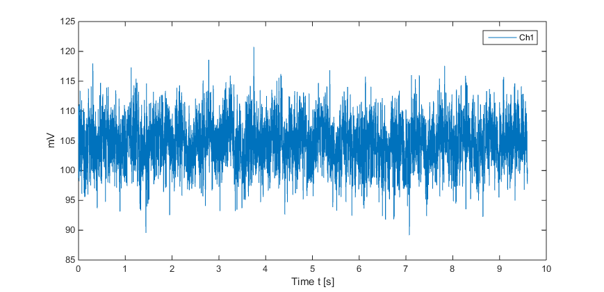

My Problem is, I am noticing a lot of noise on the input channels, way more than the datasheet specifies.
Channel 1, input shorted:

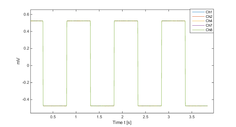

Also the internal test signal seems to be really noisy.
Channel 1, gain 12, source internal test signal:
Another thing I noticed is the test signal is only noticable if I configure the channel with gain 12 (0x65) instead of 6.

    Thank you for the time and detail you put into your question. This is good information to work from! When I saw noise coming from the test signal, my gut reaction was that there might be noise on the reference. From your schematic, it looks like you intend to use the internal reference. In the pseudo code you posted, I do not see a write to the CONFIG3 register to turn on internal reference buffer. Perhaps you forgot to include that in your post. If not, you'll need to set bit 7 of the CONFIG3 register. If you intend to use the 4 V reference voltage rather than the 2.4 V reference, you'll also need to set bit 5 of the CONFIG3 register. However, only use the 4 V reference if you are using a 5 V analog supply.
    If the reference is configured correctly and the noise still looks the way it does in your pictures, then I have a couple of questions. Have you manipulated the data in some way to obtain the offset you have in your voltages? The picture of the output is shorted is centered at 105 mV and the test signal is centered at about 160 mV. In both cases I would expect both signals to be centered around 0 V. When you say that the channel 1 input is shorted, do you mean you literally connected the wires? Did you instead configure the CH1SET register to short the inputs internally? If you have not done the latter, I would recommend trying it and seeing what you get.

    thank your for your quick response. You were right, I forgot to include the line about CONFIG3 register. I am using 4V internal reference, so I set bit 5 in CONFIG3 register, apparently I forgot to enable the reference buffer. So you were correct again, guessing that.
    Now my internal test signals should be fine:

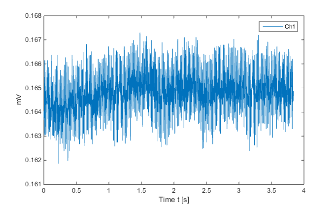

    Also I have shorted inputs of channel 1 externally and measured noise again:
    The 3-4µVPP are inside the datasheets specifications. I am still getting an offset of about 160µV but that should not affect my application.
