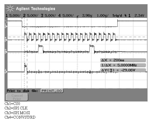

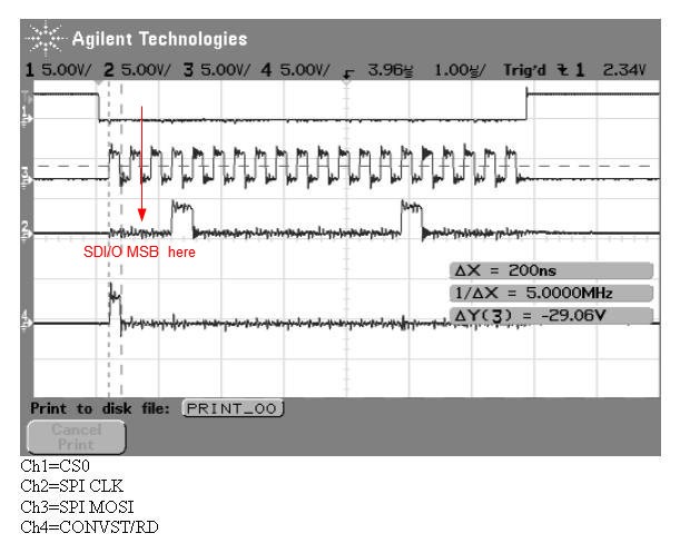

    Here is a screen shot of my signals. Please let me know if you see anything strange. This is writing the 0x1002 for the REF01 write command.
  • Sorry Bob -
    I added an extra four bits, 0x07FF and 0x01FF is what I meant.  With CH 4 as RD+CONVST you need to ensure there is enough setup and hold time against the falling sclk to satisfy tS1 and tH1 noted on page 11 of the datasheet.  Also, that 'clock' during RD does not count in the SPI transfer - for both input and output data, the MSB would be on the next clock.  If RD is getting acknowledged, the ADS8363 thinks you are writing 0x2004.
  • HI Tom, So it sounds like I need to set my data width to 21 bits since I'm timing RD/CONVST off of SCLK? I thought I was exactly matching the diagrams in the data sheet. Please see figure 40. It shows 20 clocks with RD/CONVST coincident with the first clock.
  • Hi Tom, So with 21 bits I am able to update the Ref DAC's as expected. I'm assuming you agree that figure 40 in the data sheet is wrong, in that the convst/rd bit should be on the left of the vertical line instead of the right. This error in the document caused me quite a bit of unexpected delay in development.
