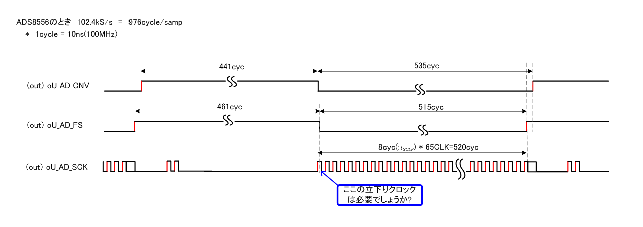

    Thanks for your reply.
    Yesterday I talk with customer and got a question again.
    Our customer tried as follows, but in case of 1st SCLK start from L when nFS assert, the data seems out with bit shifted.
    Does the he ADS8556 need to start SCLK=H when nFS assert? (It means that need SCLk negedge after  nFS assert?)
    Also when using only A/B, if we applied more than 64bits, the undefined CONV_C will be shifted out?
  • Hi Keiichi,
    Yes, SCLK on the ADS8556 is expected to be high while nFS is asserted low.  If only CONVST A/B are applied, there will not be a conversion of the CH_Cx channels.  If you continue past 64 SCLK cycles in this case, you would read the old conversion data that is still in the CH_Cx buffer.
