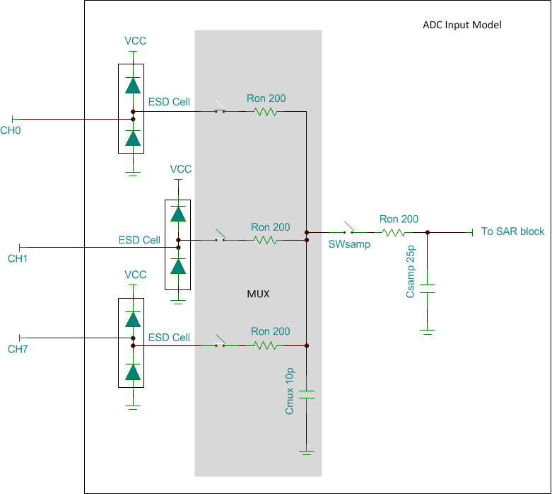

    - What kind of switching regulator is this? Please note that the ADC input is not a high impedance port. It consumes load current during acquisition and perhaps what you're observing is an effect of the dynamic interaction between the power converter output impedance and the ADC input load
    - Have you tried inserting an op amp buffer between the regulator output and the SAR ADC input for isolating the ADC load?
    Below is an approximate representation of the ADC input:

    From an initial analysis, it looks like your regulator may be very sensitive to load current changes at its output. Not only is the regulator driving a switching voltage signal across the load, but there is also loading due to switching activity at the ADC input. Evidently, this is modulating the pulse width of the PWM signal which is producing excessive noise at the ADC input (~2us of peak-to-peak jitter producing 500mVp-p of noise at the ADC input). Besides, you mention that the jitter is sensitive to something as small as scope probe capacitance.
