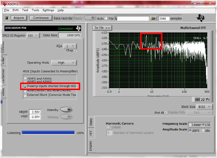

1) When we did FTT analyze with shorting A+ and A- on J6A of ADS1282EVM each other, we found peak noises at 20Hz and 40Hz.
Please let us clarify whether these peak noises are also Idle Tones.
2) When setting Preamp inputs shorted through 400ohm, the above peak noises were moved.
Please let us clarify whether this was caused by the offset differences on this device and input amp on board or not.

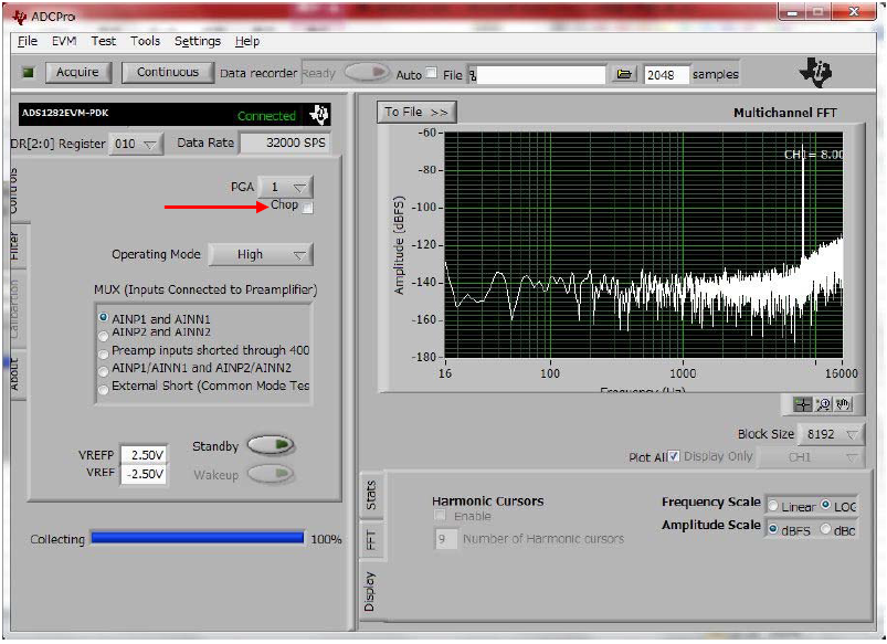

3) When referring "Figure 35. PGA Noise" on page 15 of ADS1282 datasheet, we found that the frequency characteristic would be changed based on the status of PGA Chop.
However, we could not find out this characteristic change on ADS1282EVM even though we change the status of Chop checkbox.
Please let us clarify how we could observe this on ADCPro.
4) Even though we did uncheck the Chop checkbox on ADCPro, we still observed 8kHz peak noise if observing with setting SINC filter into 8kHz.
Please let us clarify how we could resolve this issue.
