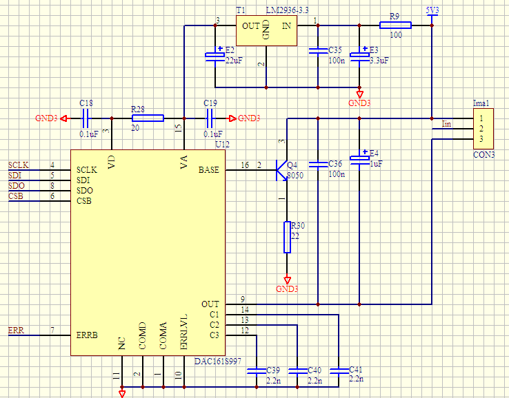

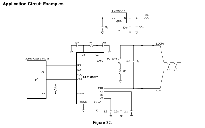

   In the circuit, where the  triangle ground  comes from? Where the power supply comes from?  Is The Loop- pin connected with power supply's negative terminal?
My circuit with DAC161S997 is like this   But the voltage in the point of 3 pin of LM2936-3.3-Vout- is 4V,what wrong with the circuit?
