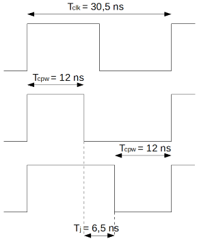

    so the maximum allowed clock jitter should be <6,5 ns across full operating temperature range to get performance similar to the datasheet, correct?

  • Hi Rui,
    I believe SNR is also measured with a -0.5dBFS input, but let me verify that with a designer. You should meet SNR specs if you adhere to the timing requirements, but of course other factors can introduce noise into the system and degrade SNR.
    The effect of clock jitter on tCPW is exactly as you drew it, although I expect a low-jitter oscillator to have jitter on the order of tens of ps. :)
