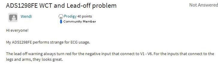

Hi everyone!
My ADS1298FE performs strange for ECG usage.
The lead off warning always turn red for the negative input that connect to V1 - V6. For the inputs that connect to the legs and arms, they looks great.
So I guess my WCT output on ADS1298 has something wrong.
Since the lead-off detection applied a load detection way, I thought that the WCT output can be a load both for positive and negative input. So the WCT is connect to the positive input, to check if the WCT is in trouble. However, when the WCT connect to the positive input, the lead-off warning turns green for the positive one!
I don't know why the WCT fail for the negative inputs while they success for the positive inputs.
And since the V1-V6 is lead-off, the board could not use for ECG measure. No signal is detect for the V1-V6. Although signals for Leads looks well.
I tried to measure the output voltage of the WCT output, it is 0.7V in average. Is it all right?
Please tell me how to fix that.
Thanks for your kind help!

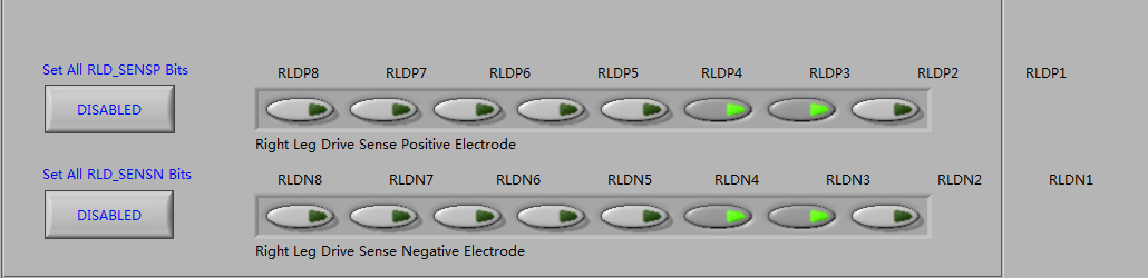

  • Hi, Abhishek!
    My setting are like following pictures
    For channels:
    For right leg drive
    For WCT
    I think that's all the settings. And I'm sure that they worked.
    Hope these settings can help you fix the problem.
    Wendi

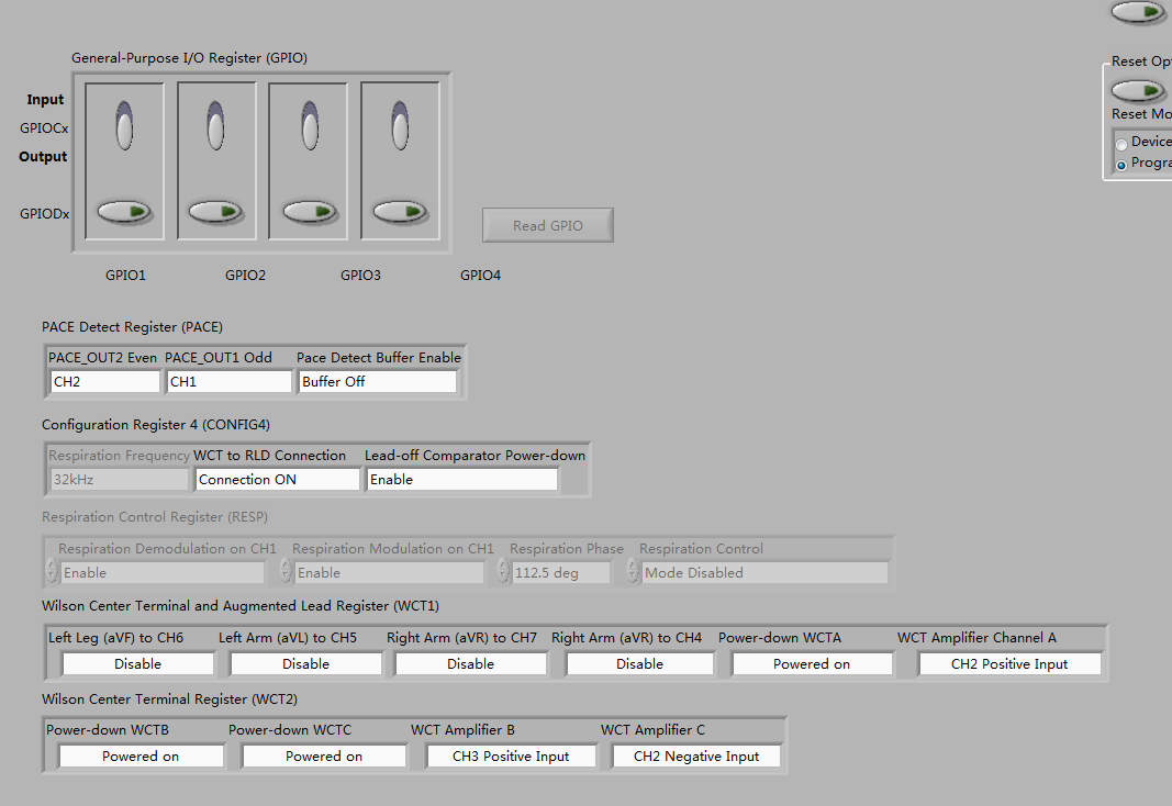

  • Hi Brian,
    Thanks for your reply.
    I've trun on the power for  WCTA, WCTB and WCTC. They are LL, LA, RA.
    The WCT1 and WCT2 registers are setting as follows,
    And for lead off setting,I use that shown in PDK. That is to enable all LOFFP bits and the LOFFN2 bit, while others are not enabled. These setting used to work out well. There were ECG waves on the scope.
    However, I tried the same setting, and the lead off problem came out. I tried to change the lead-off setting, but they donot work any more. Turned on all the LOFFN bits resulted in the same lead-off warning.
    Thanks for your kind help.

  • Hi Wendi,
    Thanks for your detailed response. When you said the voltage at your WCT pin was 0.7 V, is that with respect to AVSS? If that is the case, it may be low enough to trigger the lead-off comparators. You were partially right about how the lead-off detection works. It's not as much load measurement as it is voltage measurement. The lead-off comparators on the negative side will rail if the voltage at the input gets too low which, when the load is high, tends to happen. However, the load does not need to be high for the negative input voltage to be close to AVSS. Since the WCT output, which you are feeding to the negative inputs, should be the average of the LL, LA, and RA voltages since you said those were the leads that you were using as your input to the WCT amps, is that the voltage you expect? Probe the LL, LA, and RA leads yourself and calculate the average. If the average should in fact be 0.7 V, then the lead-off comparator is triggering simply because the input to the negative leads is too low. You could fix that by increasing the common mode input voltage on the positive leads to something that won't trigger the negative lead-off comparators.
