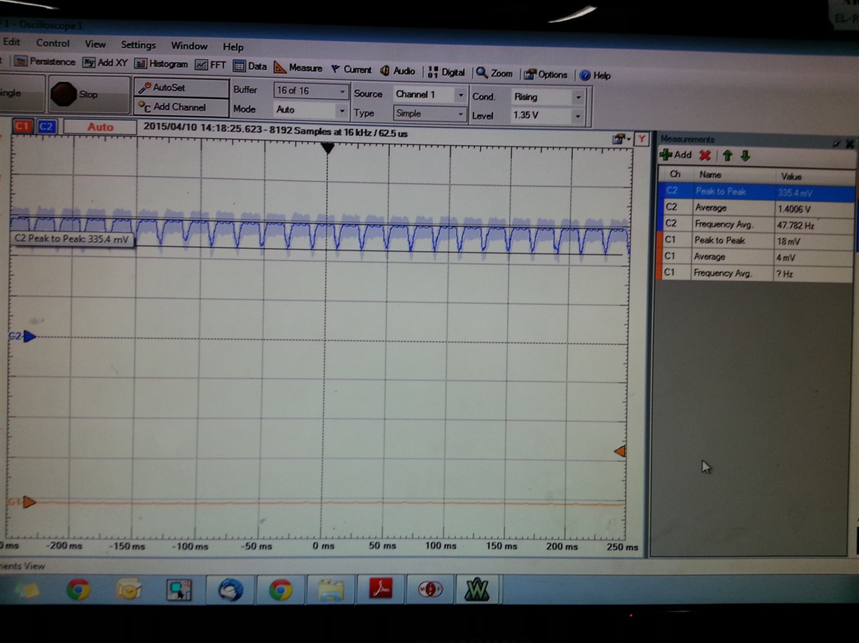

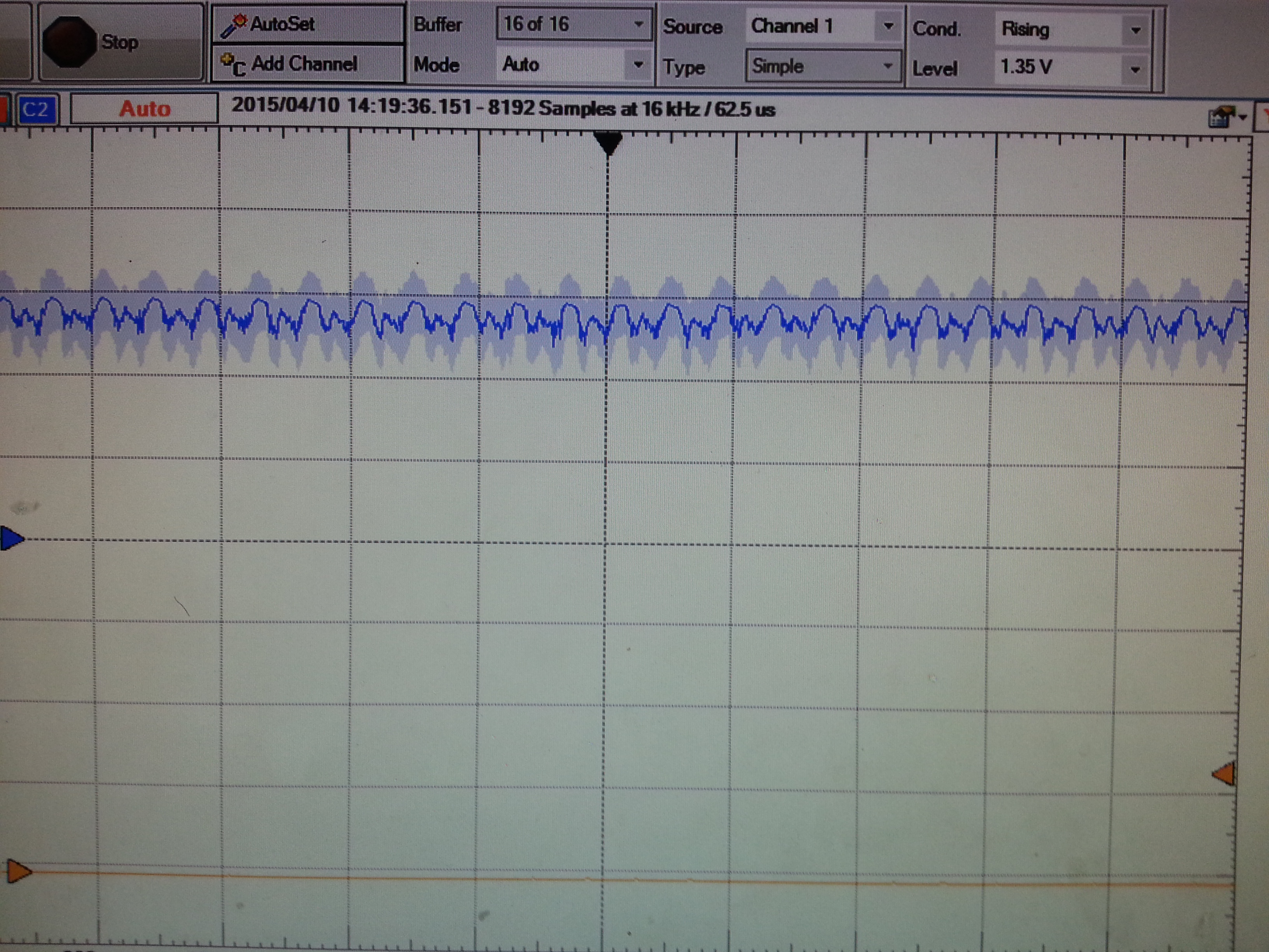

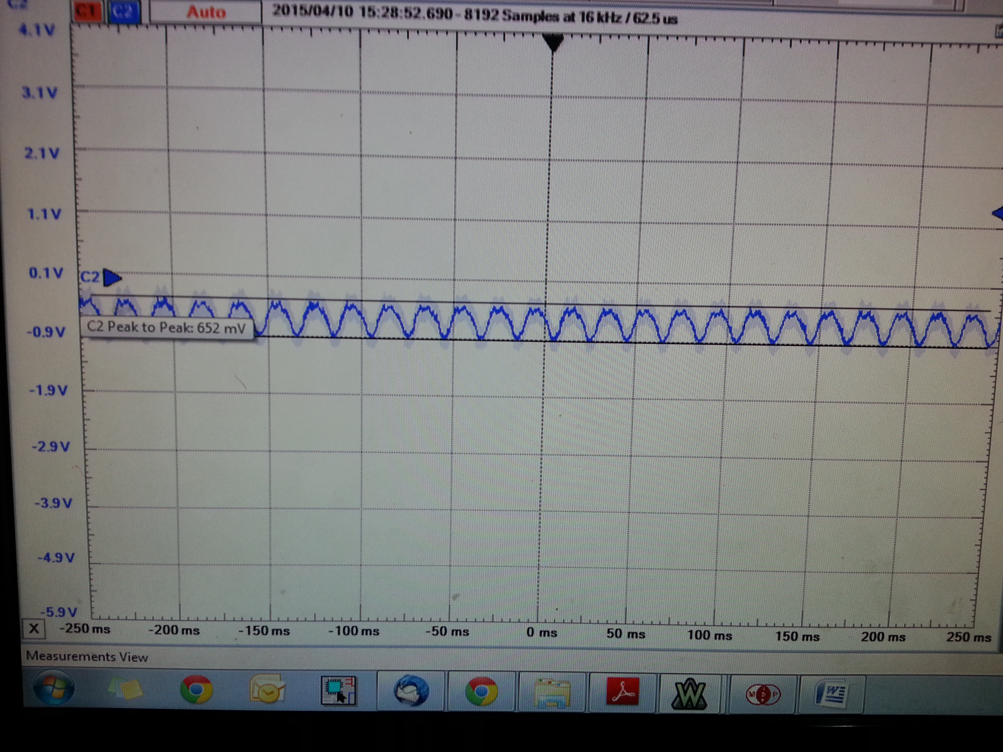

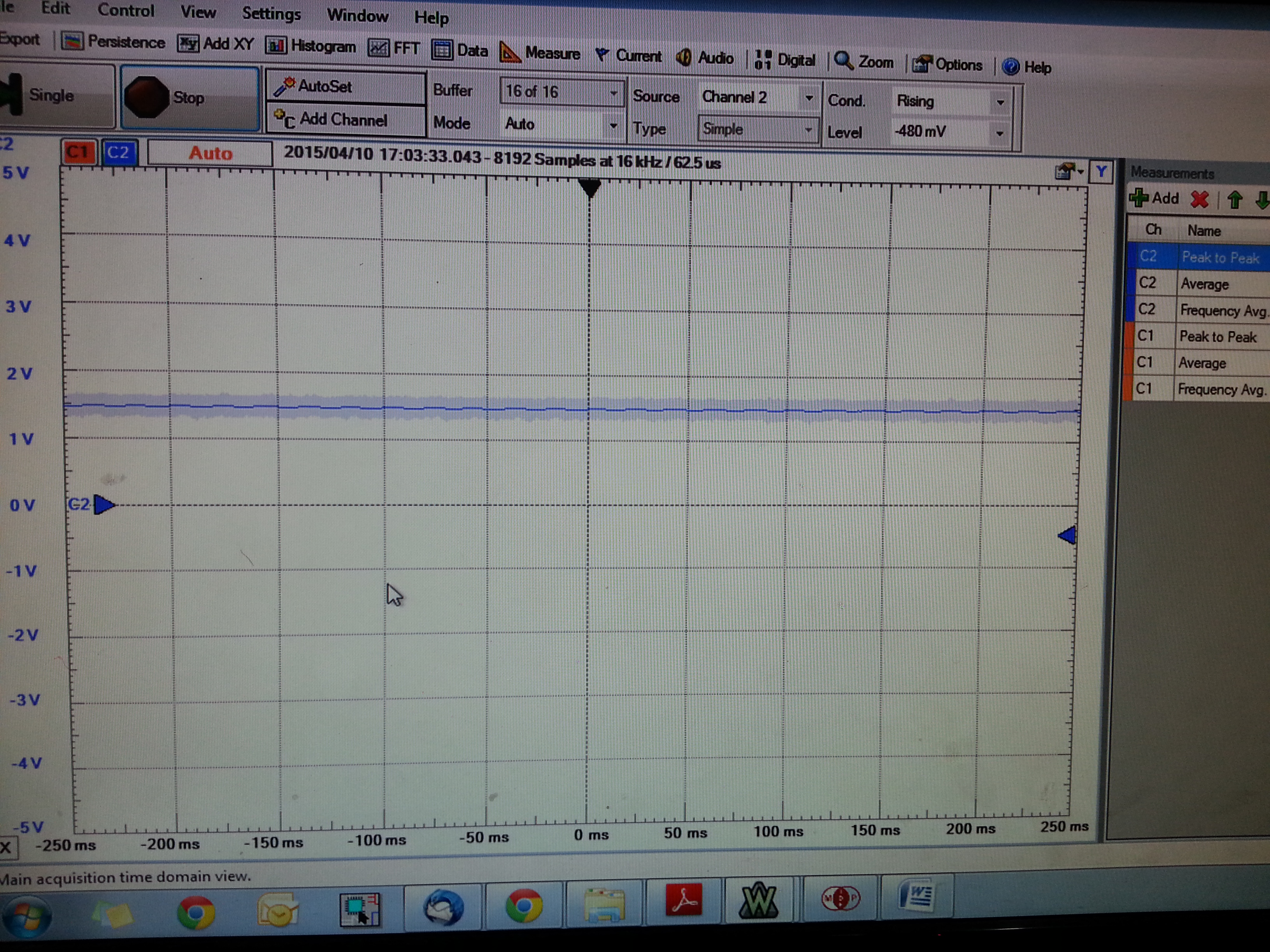

  • Thanks Mr Brian Pisani added following circuit with previous schematic in order to get respiratory wave
    op.pdf
    AVDD=+1.5V
    AVCC=-1.5V
    DVDD=+3.3V
    DVCC=ground
    got following output
    1. output between PGA1P and PGA1N
    when electrodes held in hand
    when connected across PGA2P and PGA2N got following output
    by connecting right arm and left arm electrodes
      across PGA1 getting 400MV by connecting electrode getting 700MV
    similarly across PGA2 getting MV signal by connecting electrodes 1v
    1. not getting correct ECG wave and Respiratory wave??
    2. whether above wave is noise or iam getting correct output??
    3. whether i must add amplifier and filter circuitfurther to get correct wave in LABVIEW DAQ??
    4. If yes please send me the circuit??
  • Hello Srividhyasakthi,
    It's hard for me to tell if you are getting any of the correct waveforms. The signals that you are showing me have a fundamental frequency of around 50 Hz which is probably the utility frequency in your region. You should try to make your inputs as free of noise as possible. In addition, an ECG amplitude could be as little as a few millivolts so you'll have to decrease your volts/div on the scope to see that. The respiration signal will also be a few millivolts and probably have a frequency of less than 1 Hz so it's important that you can protect your measurement lines from noise.
    I'm not sure how you'd measure that signal using a LabVIEW DAQ and unfortunately I do not believe we have one for the specific setup you are describing.
    Brian Pisani
