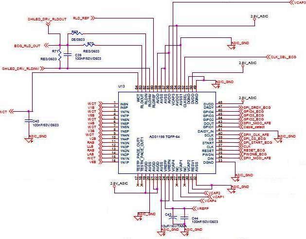

I have configured the ADS1198 to acquire ECG.
Whenever i configure LOFF_FLIP (Address = 11h) value to 0xFF, i get lead-off status correctly for all leads except Right Arm lead.
And when i configure LOFF_FLIP=0x00, i get lead-off status for Right Arm lead, but not other leads.
Can anyone please tell me what the problem might be ??
I am sharing the ADS1198 connection diagram.
Warm regards,
Abhishek.
  • Hello all,
    I am sharing my leads-connection diagram.
    Abhishek.

  • Hey Abhishek,
    Looking more carefully at your schematic, the path for the input doesn't terminate at the connector. What is located to the left of all of those connectors? I fear that by taking off the resistors you may have reduced the impedance to ground versus making it infinite. Also, have you tried doing lead-off detection using the internal pull-up/down resistors as opposed to the current source lead-off detection?
    Brian Pisani
  • Hello Brian,
    The components on the left of all those connectors are EPCOS Surge Arrestors. They are used to remove any surge in the circuit.
    Right now, we have not connected these Surge Arrestors in our circuit.
    So you mean that the R86(10Mohm) resistance is necessary and should be connected in the circuit ??
    Yes, we had tried the pull-up/down resistor mode, but that didn't work. So we switched to current source mode for leads-off detection.
    Thanks and regards,
    Abhishek.

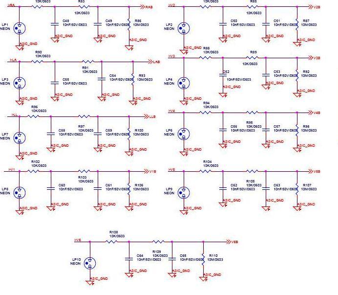

  • Hi Brian,
    I probed the voltages on the leads. For all other leads, upon leads-off, the voltages fall below 30mV and i get leads-off status correctly.
    But only for RA lead, the voltage falls to about 50mV.
    Moreover, i have connected the same components for all the leads, so why is only RA not indicating leads-off. ??
    Abhishek.
  • Hey Abhishek,
    The lead-off circuitry has pretty wide tolerance since it was not designed for precision. One strategy would be for you to tighten the comparator threshold in the LOFF register such that it will trigger at a higher voltage.
    Brian
  • Hi Brian,
    I changed the comparator thresholds to 70%-30% and also changed the Lead-off current magnitudes between 4nA to 16nA.
    But i am still not getting RA leads-off.
    Abhishek.
  • Hey Abhishek,
    Can you tell me what voltages you measure across the passive components in the path of the RA electrodes?
    Brian
  • Hi Brian,
    I am getting the following voltages across the passive components of RA lead.
    1.49V when lead is connected and 136mV when lead is disconnected.
    These voltages are across R86, C49 and C48.
    Abhishek.
  • Hey Abhishek,
    Have your tried depopulating those pull-down resistors? If you depopulate R86 and preform lead-off detection in current source mode it should work.
    Brian Pisani
  • Hi Brian,
    Yes, i got leads-off when i depopulated the R86 resistor !!
    But why this happens with RA lead only, and not with other leads ??
    I still have the 10Mohm resistors connected to rest of the leads, and they detect leads-off correctly.
    Abhishek.
  • Hey Abhishek,
    This is because the RA electrode is connected to a negative channel input whereas all the others are connected to positive channel inputs. A good way to think about it would be to draw a schematic and create current sources of the magnitude and direction specified by your register settings and calculate the ideal voltages that appear at the inputs in the case where the electrode is off.
    Brian Pisani
  • Hi Brian,
    Thank you so much.
    I understood it now.
    Abhishek.
