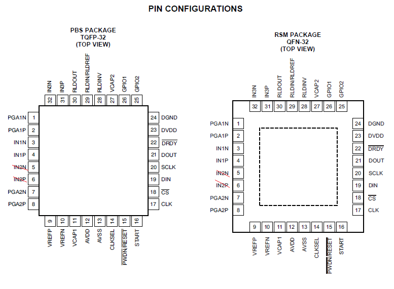

I have 4 questions about ADS1191/ADS1192 and ADS1x9xECG-FE
1.)How should we connect to IN2P and IN2N of ADS1191(ADC 1ch)?
   Customer wants to use ADS1191(ADC 1ch).    Datasheet page9 and 10 describe 'PIN CONFIGURATIONS' and 'PIN ASSIGNMENTS'.    It seems for ADS1192(ADC 2ch), because these have IN2P and IN2N(ADC Chennel2).    Do you have 'PIN CONFIGURATIONS' and 'PIN ASSIGNMENTS' for ADS1191(ADC 1ch)?       If ADS1191 and ADS1192 are same 'PIN CONFIGURATIONS' and 'PIN ASSIGNMENTS',    How should we set for IN2P and IN2N of ADS1191? Non-connection(N/C) or GND?

  • Hello y.i,
    1. On the ADS1191, you should short the channel 2 inputs together. No need to tie them to ground.

  • Hello Brian,
    Thank you for your answer.
    Our customer would like to know the detail about question No1.
    Could you recheck following 3 questions?
    a.) I think that datasheet describes 'PIN CONFIGURATIONS' and 'PIN ASSIGNMENTS' based on only ADS1192(Not ADS1191).
       May I understand that pins of ADS1191 are the same 'PIN CONFIGURATIONS' and 'PIN ASSIGNMENTS' except IN2P and IN2N ?
    b.) Do you have a plan to describe 'PIN CONFIGURATIONS' and 'PIN ASSIGNMENTS' of ADS1191 on datasheet ?
    c.) Could you explain why should we deal with following about IN2P and IN2N?
       Are these IN2P and IN2N connected to circuit such as ADC inside chip of ADS1191?
       (IN2P and IN2N are not N/C pin for ADS1191 ?)

  • Hello y.i,
    a. Yes the pin configurations and pin assignments are exactly the same from the ADS1191 to the ADS1192 with the exception of the channel 2 input pins on the ADS1192, which are to be shorted together, and the PGA2N and PGA2P output pins, which may be left floating. This device only has one channel, but the pinout is exactly the same as the two-channel device. You can expect functionality to be nearly the same as the two channel version.
    b. At this time no, but I could foresee some more descriptive language in the existing PIN CONFIGURATIONS and PIN ASSIGNMENTS sections about how to deal with the unused pins on the ADS1191 make its way into the next revision. Thanks for your feedback on that!
    c. To see maximum power performance, it is advised that you short those pins.
