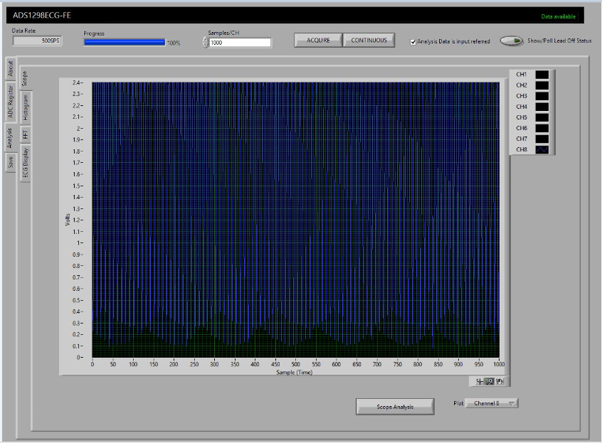

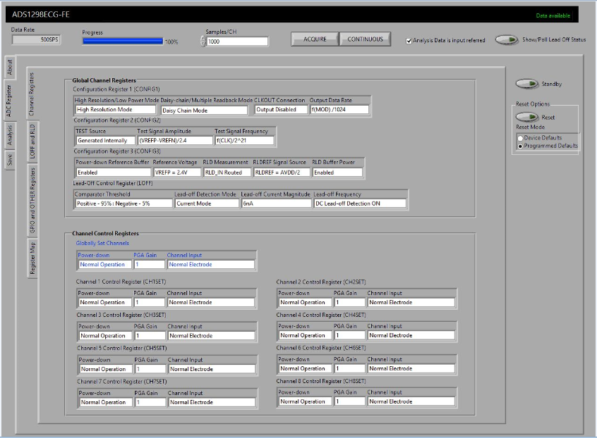

    I am connecting the function generator to the ADC side on the pins marked with + and - for CH8. But the software's Scope tab does not display the signal that I have input. I am attaching the screenshots for the control register settings that I have set .
    The input signal is a 13 Hz- 1V sine wave. However this is what the scope is showing.

    Looking at your signal, that fast frequency waveform seems to have a period of around 10 samples which is roughly 500 SPS/10 S = 50 Hz which is probably the utility frequency. That frequency is being coupled to your inputs from your signal source. To see whether or not your actual signal is making it to the ADC, check the FFT tab and see if you can identify your signal in its respective frequency bin.
    As a side note, you're going to need to set your common mode to a valid range somehow since it looks like your signal generator is at an offset with respect the the board. One way to do that with your current setup would be to hook the ground wire of you signal gen to the board AVSS which corresponds to -2.5V. Then you could give the signal you generate an offset of 2.5 V to put its common mode at 0 V with respect to the ADS1298. The signal wire can connect to the positive input of the channel and the negative input can be wired to the RLD output. Make sure the RLD amp is configured as just a mid-supply buffer rather than using channel inputs to determine its outputs. That way when the ADC measures the differential voltage on the channel, it measures your input signal with respect to the mid-supply voltage which is zero volts. This method may seem roundabout, but setting the common mode for biopotential measurements is a challenge in the first place and so the EVM was designed to showcase this device's ability to do that using the RLD amplifier. If you have a simpler way of setting the common mode for your purposes, then by all means you can do that instead.

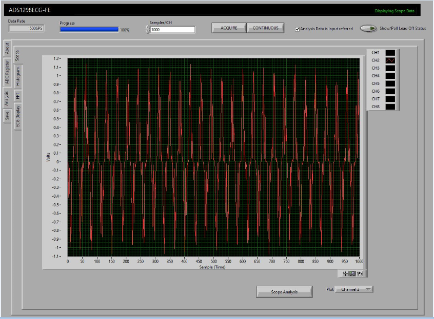

    I have connected the function generator to channel 2, JP32 between Pins 2 and Pins 4. I have given a sinusoidal signal of 13Hz. This is the resultant waveform I am getting. It seems the offset problem has disappeared.

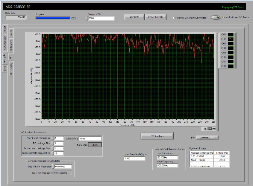

    And here is it's FFT. I cannot see any frequency at 13Hz. Does it mean my signal is not reaching the ADS?
  • Hey Kormal,
    Looking at your first image, the period of that waveform looks to be around 40 samples which at 500 SPS corresponds to a frequency close to 13 Hz so I think your signal is getting to the converter! Also, to get a better picture of your spectrum, you should try to change the display so 0 dB is at the top of the graph.
    Brian Pisani
