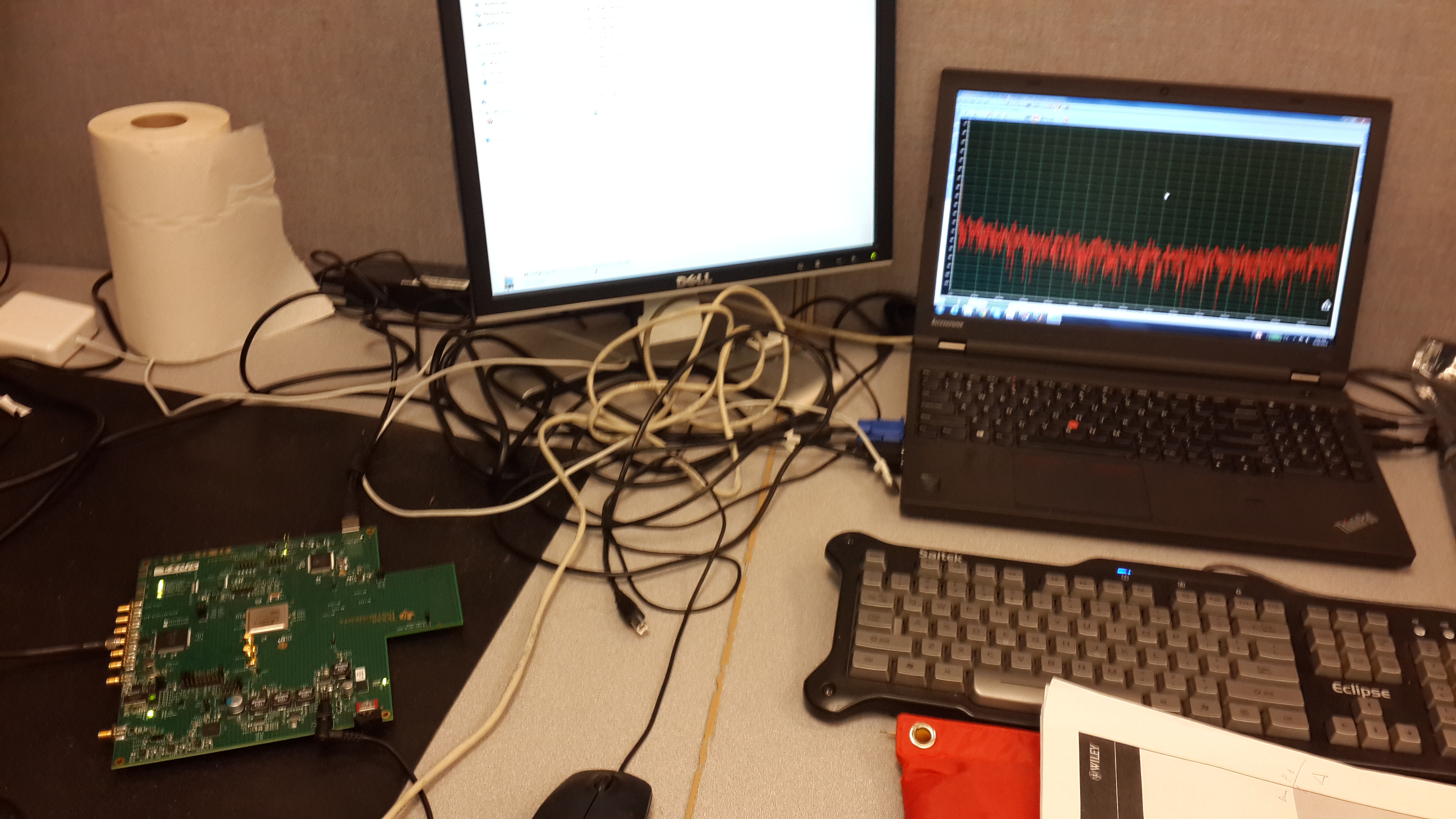

    Can you send a picture of your setup, along with a snapshot of the Wavevision GUI showing the time domain waveform and board configuration (input and sampling mode and capture depth are the most important)?

    ADC-WB-BB  (I used it but only observe noise. the photo was taken while the board does not connecting with the balun)

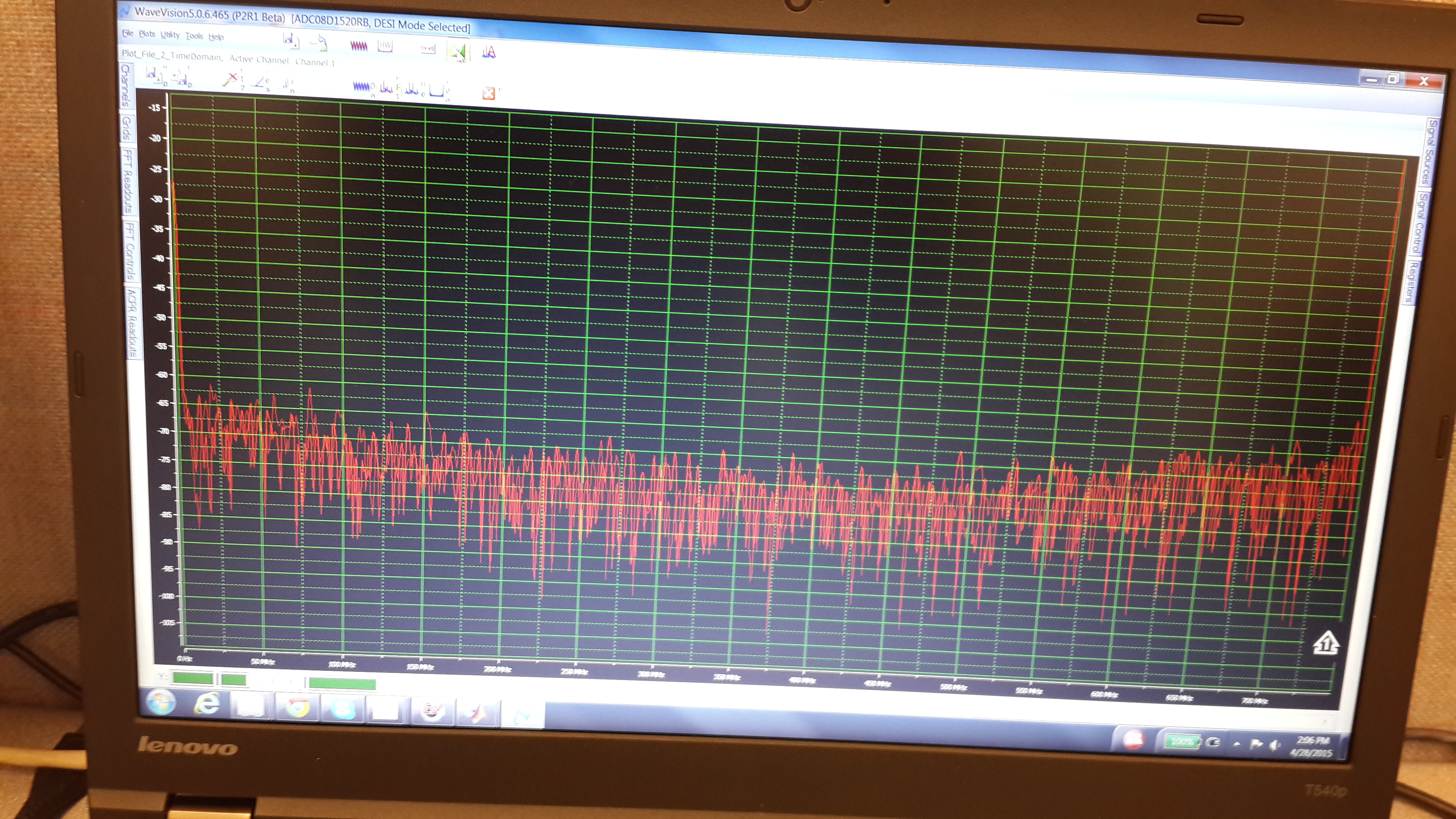

  • Thank you very much for your reply, Jim.
    1. The common mode of the board might cause harmonics which is up to the input signal level, but it does not affect the board to digitize the input sign. In the attached the photo, only noise is digitized as showing in the following photo.
    2. The differential signal will help to provides more precise signal level. If only on of v_in+ an v_in- is fed a sine wave, the board at least be able to return a peak of the sine in frequency domain. However, the board only returns noise.
    3.I only have the board with me now and that picture I just photoed is to show  basic connection. When i was doing testing, I have all those required pieces suggested by the user guide, but WaveVision only returns noise. Thus, I suspect the problem is caused by the board itself. Adding dc block, balun, and even a filter between signal generator and the board does not do any good for observing a peak of the input sine wave in wavevision.

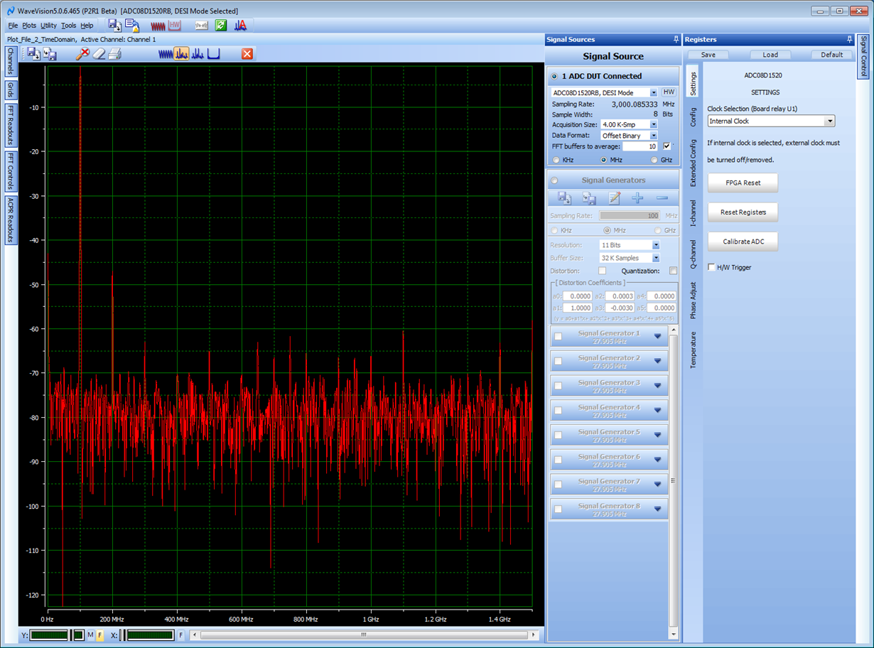

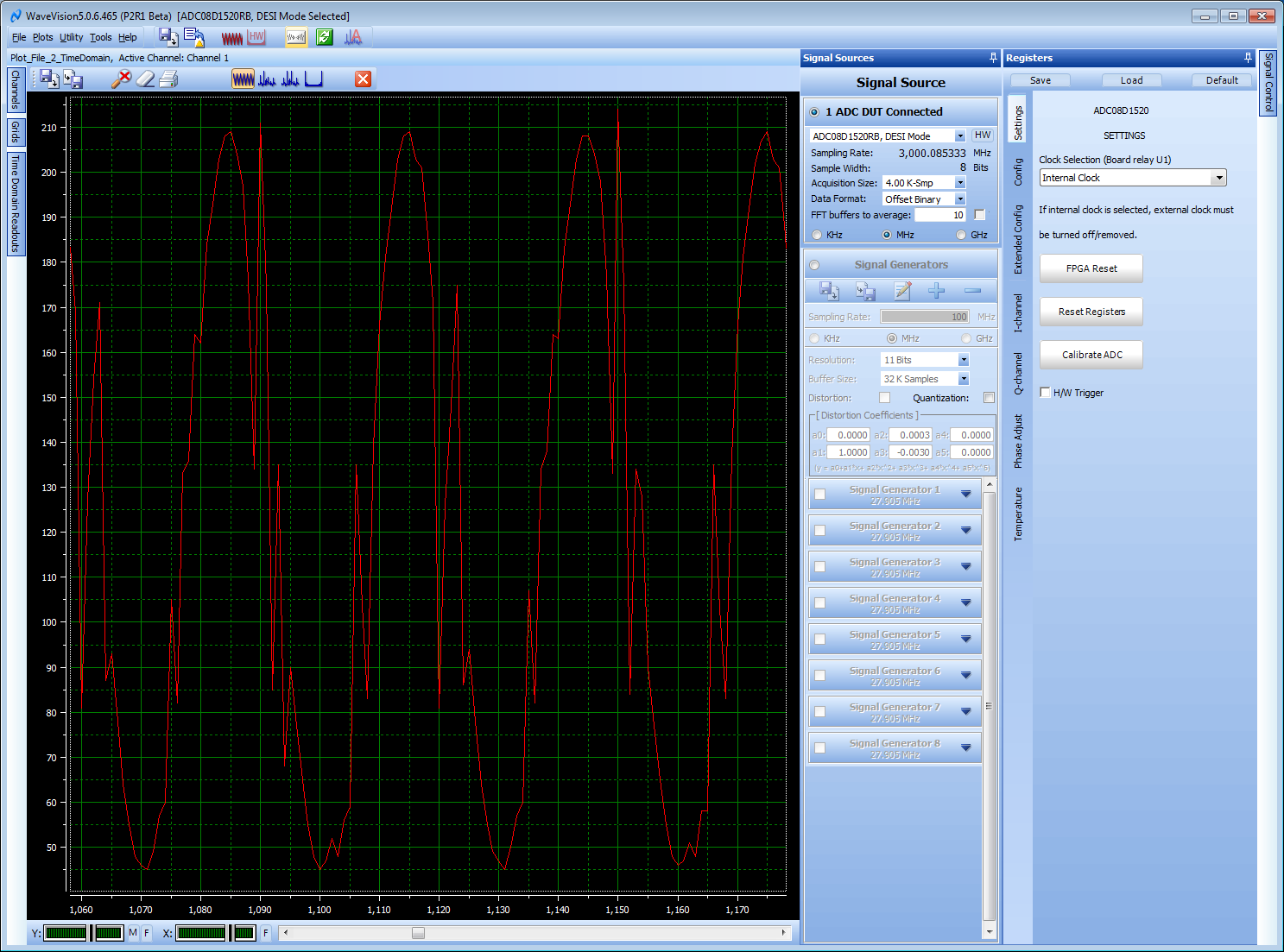

    For that mode and with a 100 MHz input at -1dBm applied to the balun board this is what the time and frequency domain plots should look like:
    Time
    Frequency
    I also tried applying a SE signal directly connected to VIN- with no DC block. Here is what that looks like, the distortion caused by driving the input in that manner is evident, but there is some resemblance to a sine wave.
    Please confirm your signal generator output using an oscilloscope. If the signal is as expected and you are still unable to get the expected capture into the ADC08D1520RB please proceed with a warranty return.
