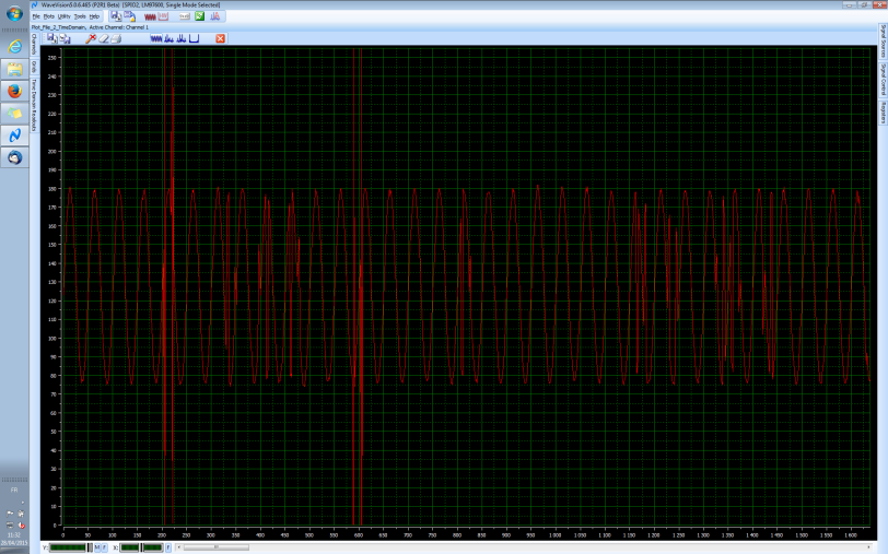

I use Wavevision5.0.6.465 HS11  with LM97600rb.
I try to reload FPGA bit file with Tools->Hardware access Panel -> Default image for selected hardware -> spio5.5_xc5vsx95t_lm97600.bit
Since this manipulation I get the following result for sinusoïde input on channel 1
Acquisition channel: 16ksamples
Input select 00=input1
ADC mode: 00= single ADC
sync req is done and all byteAlign and ChanAlign are set to 1
As you can see one the screen shoot  lot of sample are wrong.
I try to regenerate bitfile from FPGA source with ISE 12.4 and load it with same procedure and the result is same.
I also try to uninstall and re-install wavevision with no effect.
Does the spio5.5_xc5vsx95t_lm97600.bit is the correct default bit file?
Do you have an idea what is wrong?
