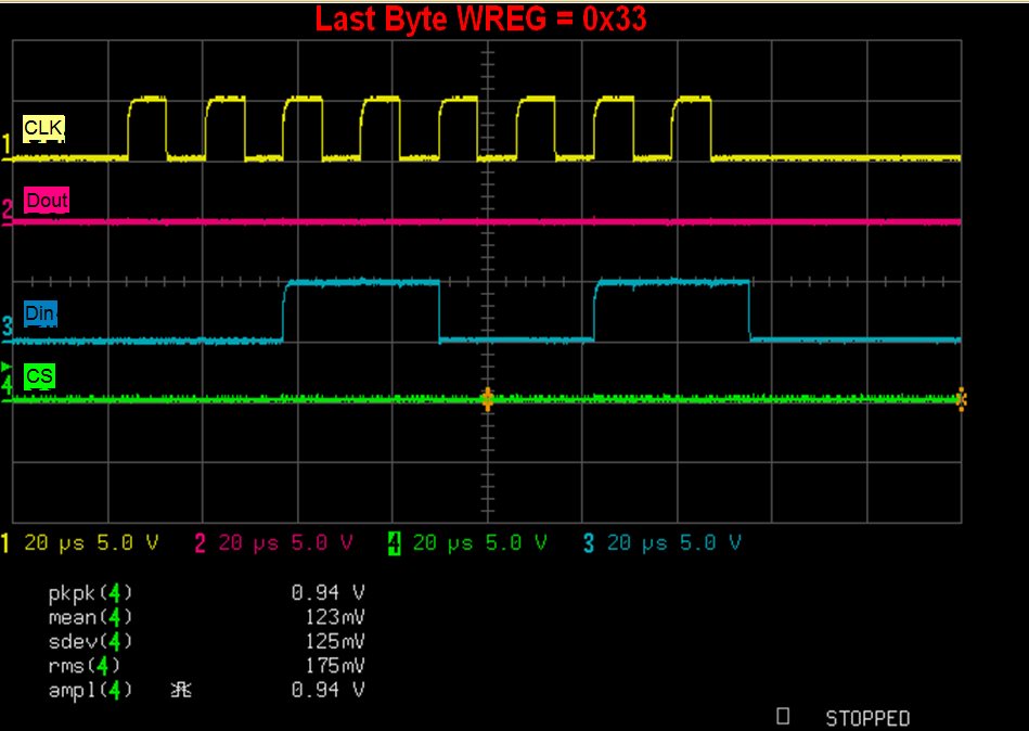

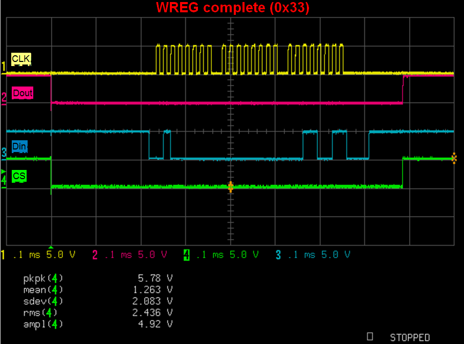

  • Find attached some scope images of SCLK, DIN, DOUT, CS that demonstrate the problem we are seeing.
    The sequence executed is an infinite loop of the following two commands:
    while True:
       WREG: 0x40, 0x00,0x33     // write MUX0,  one byte, value 0x33

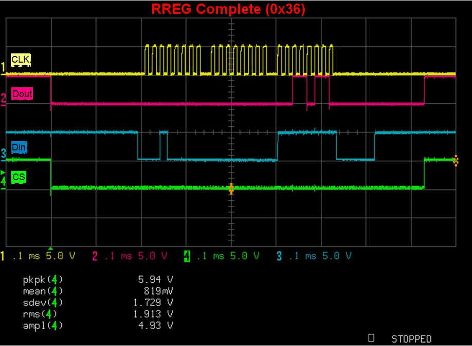

       RREG: 0x20, 0x00,0xFF     // read MUX0,  one byte
    with 0.5s sleeps between any commands
    The RREG always reads back 0x36  instead of 0x33.  This is 100% consistent.
    SPI clock is 100Khz, measurements done on a 500MHz scope.
    A detailed snapshot of the last byte shows the 0x33 written (0011 0011)

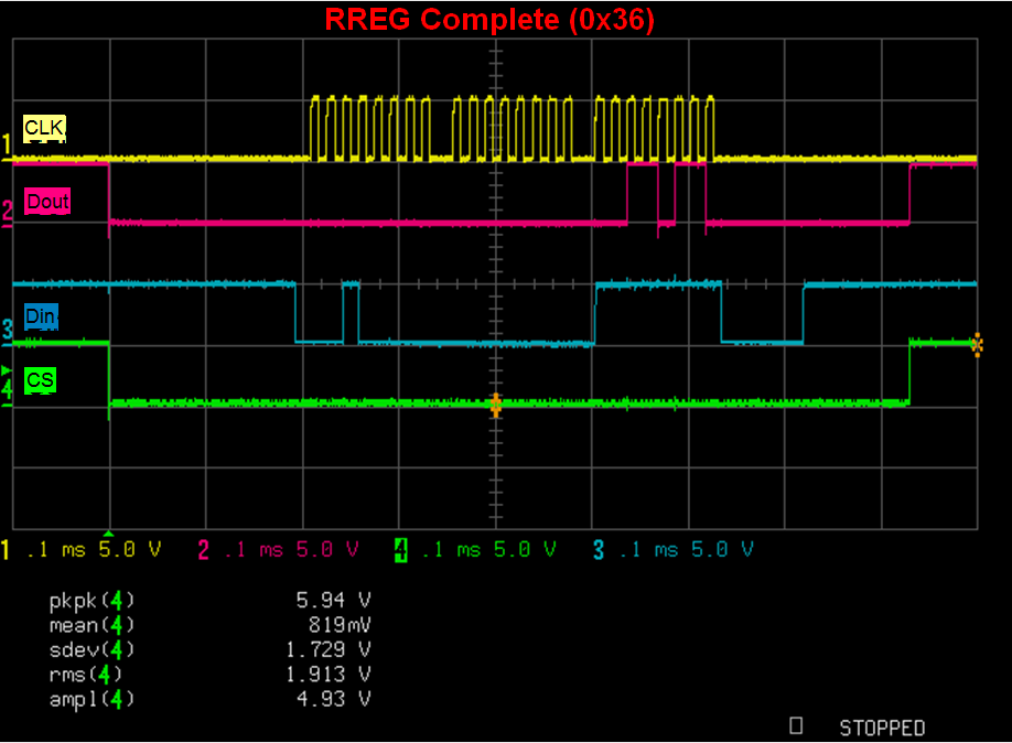

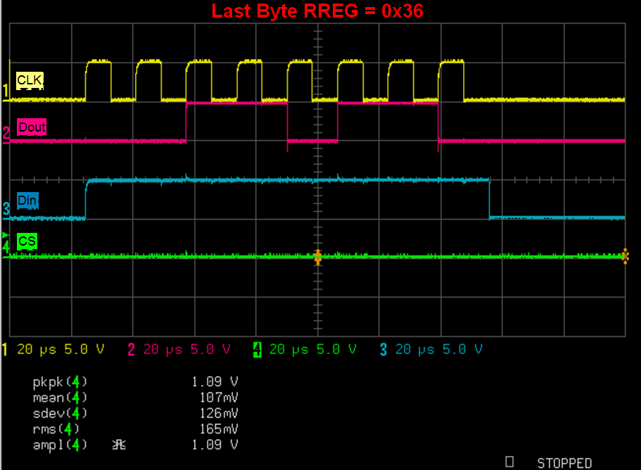

    RREG
    For read
    ing we send 0x20, 0x00, 0xFF.  We read back 0x36 (instead of the expected 0x33)
    A close-up of the last RREG byte shows the 0x36 (0011 0110) on DOUT. easy to manually decode on the falling clock edges.
  • Harm,
    The waveforms look clean and I agree that the device is reporting back something other than what you wrote into it. I assume that you have issued a SDATAC to prevent the data from interrupting the DOUT register when you are reading it out?
    Just looking at the communications, there are two things that I would try to change in the write setup. First, I'd try to have DIN low when the /CS goes low. Second I'd try to keep the DIN from changing between the last SCLK and the rise of /CS. I can't say that either would cause this problem, but at this point it's something to try.
    I may have some more recommendations in the morning, but I'll have to check on something in the design.

  • Yes the problem was caused by our SCLK. it was not clean enough. The rising edge of SCLK was not steep enough. (and wobbled a bit, causing the ads1237 to see a falling edge too).
    Lowering the resistors of the level translators for SCLK fixed it for us.
