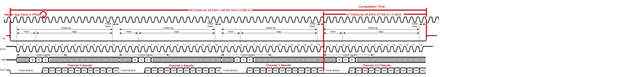

I plan on designing in a ADC128S102 in a sampled data acquisition system. The overall sampling rate is 200 kHz (5 us) and there are 3 signals which must see this 200 kHz rate, and 4 signals which will see 1/4 this rate. The channel sequence I plan on using is 0-1-2-4, 0-1-2-5, 0-1-2-6, and 0-1-2-7, being driven by a 14.65M clock. This gives me 4.5 us conversion time. I set up the following sequence - can anyone tell me if I am close?

  • sorry, I got caught up in your other question, your picture shows that you are understanding how the addressing scheme works. my only comment is your first conversion result. you will get channel zero after first power up because that is default register setting. but after power up, the address holds what what written into it during the last conversion. your calculation for conversion time also makes sense.
