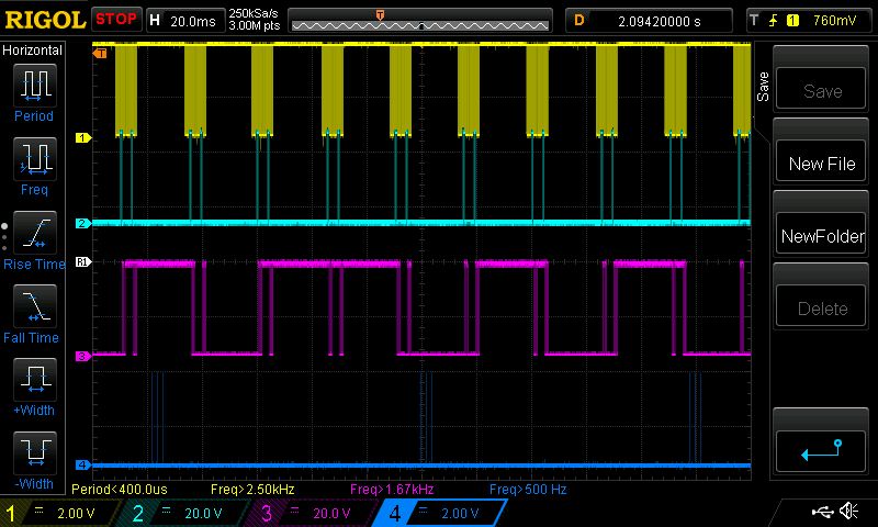

           I am trying to implement pulse oximeter using AFE4490 with MSP430, I can configure the AFE4490 through SPI and can able to read the register outputs. My question is, The AFE_ADC_RDY is not running in the same frequency of PRP(500 Hz). We were getting three pulses in the ADC_RDY signal, What could be the problem.. Is this normal activity or are we doing any mistake in hardware design and AFE4490 internal register configuration. Kindly check the attached image.
CH 1:  SCLK
CH 2:  MOSI
CH 3: MISO
CH 4: ADC_RDY

  • Praba,
    This looks more like a scope capture issue.
    Could you remove the SPI signals on other channels and trigger the capture on ADC_RDY signal?

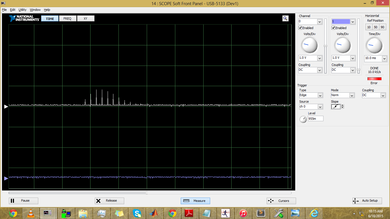

    I have the same issue. I am seeing three pulses at a time and that is all, whether I check it while the front-end software is capturing samples, or whether I use my own board (after removing the concerning 0 ohm resistors) to send data via SPI (and I have used the default register values given in the source code).
    The three pulses themselves differ by 2ms, when I keep the sampling rate as 500 Hz, and by 0.5 ms when I set the sampling rate as 2kHz (and when I set it as 2kHz, there is a similar bunching of ADC_RDY signals, but more than three - around 7 pulses). There is only one signal scoped out, and I am using a National Instruments USB DAQ to scope out the results.

  • Samyukta,
    Can you send us a screen shot of your ADC_RDY captured on a scope in the different variations that you described?
          Those three ADC_RDY pulses are related to scope capturing. We were getting that sort of signals while capturing large amount of signals. Keep your scope capturing resolution is low.. you wont get that issue.
  • Hello Amy,
    1) 500 Hz sampling = 6 spikes fitting exactly in 10ms period  gives a period of 2 ms.
    I used a resistor of 420 ohms to pullup AFE_RESET and AFE_PDNZ.
    2) 2kHz sampling rate: 20 pulses in 10ms = 0.5 ms period
    In general, I see variations when I change the pullup for the AFE_RESETZ and AFE_PDNZ. Is there any specific value and configuration that should be there?
    Samyukta
    How low should I keep the resolution? Because I have been able to see 16khz pulses accurately on the NI DAQ that I am using, so I am wondering why 500 Hz should be an issue..
    Also, the spikes that you got and that I got are slightly different. Mine are fading into zero, as you can see in the screenshot.
    Any further suggestions would be most welcome.
    Samyukta
