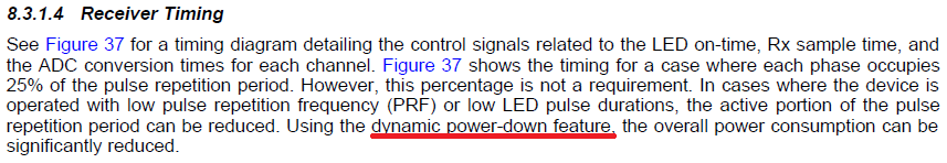

Hi Team,
I would like to ask about AFE4400.
I found the description "dynamic power-down feature" in datasheet page26.
Does AFE4400 have the "dynamic power-down feature"?
I believe only AFE4403 has the function, so I would like to confirm just in case.
