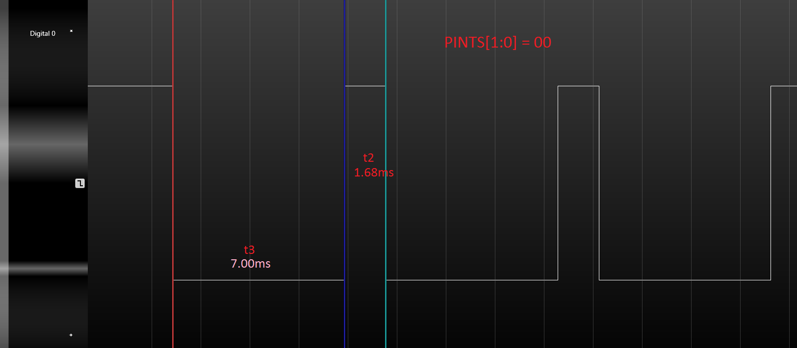

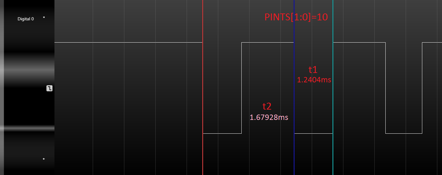

    I just took a look at your code. However, I have not found any obvious issue.  Here is my suggestion about how to debug the issue you have met with.
    Step 1 : Comment all the firmware code that reads the data from the TSC2013-Q1. Probe the /PINTDAV pin with a scope or digital analyzer and rerun you firmware.  Then if you touch the touch panel,  you should see the /PINTDAV behave like the picture below.
    If you set PINTS[1:0] = 00 (CFR2_PINTS_0), below shows you what you should see.
    Step 2: If the /PINTDAV pin always behaves as expected, your hardware should be OK. If not, I think you probably have some hardware issues on the TSC2013-Q1.
    Step 3:  Enable the code that was just commented and try to capture the i2c communications waveforms with a digital analyzer when this issue happens again.
    Andy
  • Dear Andy:
    Thanks fot the reply. The problem had not been fixed yet.
    Under normal work, The waveform is ok as you show. But when the fault was occured, /PINTDAV pin
    was no output signal. So, i have not found the reason yet.
