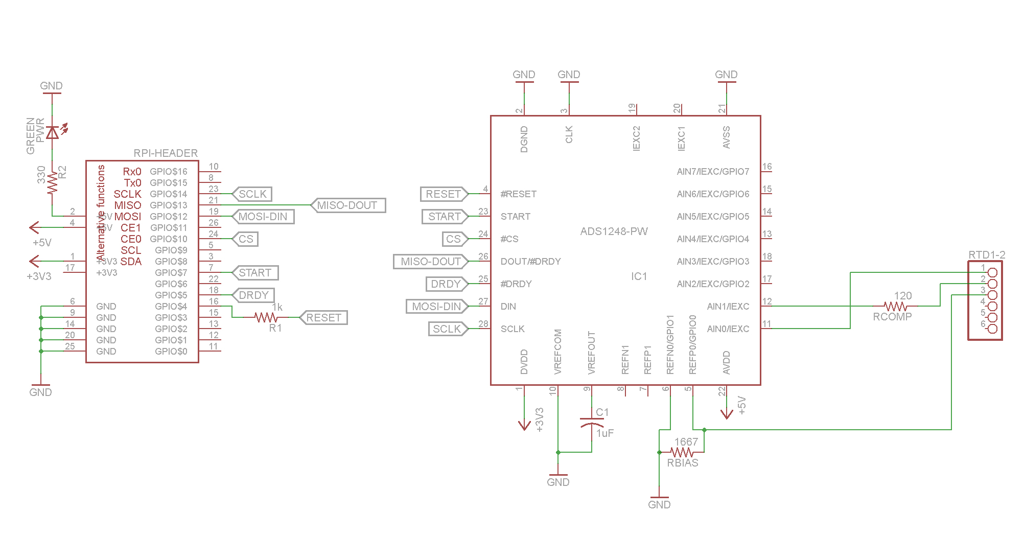

Hi all,
I'm working on a hobby project and am trying to interface the ADS1248 to a Raspberry Pi to measure liquid temperatures (0-100 deg C) with a 100ohm RTD.  I seem to be communicating with the chip just fine (can set and read the registers), however every time I attempt a conversion I get the same result (exactly mid-range) from the ADC.  This is hardly my area of expertise (I mentioned this is a hobby project), and I'm hoping there's an obvious mistake that I can't find that someone here can point me to.  I've read the data sheet and am basing the design off of the 'Hardware-Compensated Three-Wire RTD Measurement' design example.  I've double-checked the wiring and the schematic and I'll admit I'm stumped -- I just can't get any data from the ADC.
Here are the values I'm using:
R_comp = 119.4ohm (120)
PGA = 128
IDAC = 0.75mA
Vref = 2.5V
R_bias = 1667ohm
Here's the schematic:

The first set of register reads is upon chip start up, and the second set is after configuring, demonstrating that I can communicate with the chip and read registers.  The issue is that the three bytes read out for the conversion are always [127,255,255].
Thanks in advance for any help you can offer!
  • Bryon,
    The output data that you get is 7FFFFFh. This is not a midscale value. This is a positive full scale measurement. Note that the output data is represented in twos complement notation (800000h would be negative full scale).
    Since you are getting 7FFFFFh, I would generally recommend that you check that the reference is smaller than you think, or that the input is accidentally disconnected. I would measure the both with a multimeter. I would also turn down the gain. Right now, you are in a gain of 128 and it doesn't take much offset to get through the full range. Start with a lower gain to make sure the measurement is correct.
    Joseph Wu
