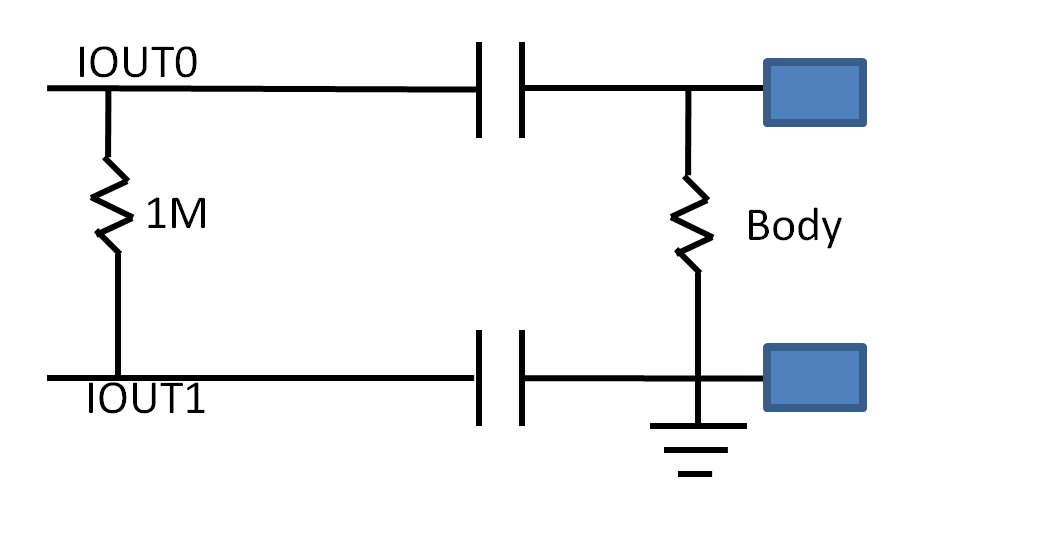

I am using the AFE4300 for a body impedance measurement device. The device seems to be operating fine with a few LSBs of noise when using FWR mode. I am also using ECG on the body and have a lead connecting the body directly to ground. I noticed that when this lead is connected to the body, the AFE4300 measurement changes slightly and becomes much less noisy (~1 LSB of noise). I also noticed that if I remove one of the two Iout electrodes and connect ground, I can still obtain an impedance signal. I was wondering a few things:
a. Is it possibe to use a ground/RLD electrode while using the AFE4300 for impedance measurement?
b. Why does a separatore ground electrode connection to the body clean up the impedance signal?
Any light you can shed on this matter would be greatly appreciated.
Thank you!

    Sorry for the late reply. Can You give us a screenshot of your signal with and without one of the IOUT electrodes tied to GND. Also I have included a screenshot image of what I believe you IOUT circuit looks like. Can you verify this is what you have?
  • Thanks for the reply. In terms of noise, the difference is really only a few LSB. But for my application, this is important. The setup is similar to what you have drawn, except that the ground is connected directly to the body through a separate electrode. I have five electrodes on the body: Ioutp, Ioutn, Vsensep, Vsensen, gnd. When I have the gnd connection (for ECG CMRR), the impedance is more stable and less noisy. However, I have also noticed that the impedance value changes significantly. For example, without the ground electrode, I obtain an impedance (adc value) of 6200 and with the ground I obtain a value of 10200. Is it possible that the current is flowing to ground through the body somehow? I am not understanding why the ground is changing the impedance value. Perhaps it's affecting the current drive circuit?
