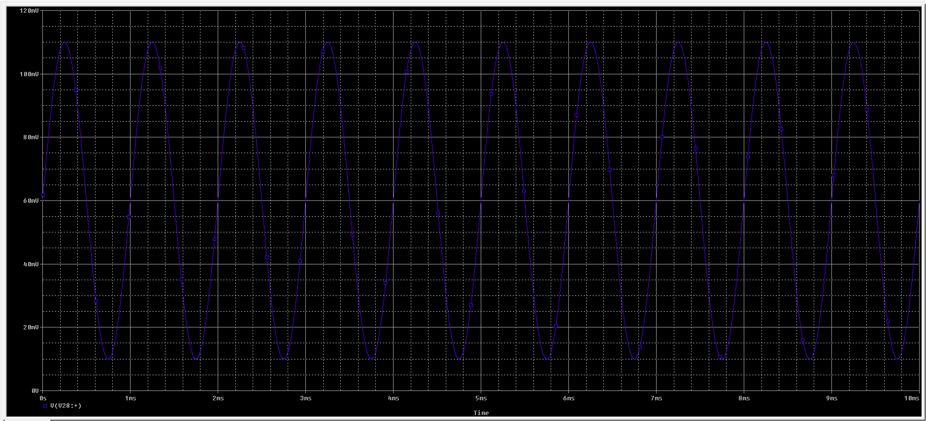

i need some suggestions for my application, i am looking for a sine wave generator ic, with adjustable offset and frequency, secondly i need to calculate phase and magnitude of a sensor is there any chip available, if they have evaluation board then perfect. at the end i would like to use chips on my designed pcb to work like a whole automated system.

  •   1) I want to generate sine wave signal with frequency 1 kHz to 1 MHz and amplitude not more than 100mV peak to peak with offset 60mV. please find attachment for sine wave generation.PNG.
