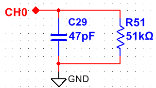

Im using an ADS7828E in my design and its giving me unstable values. Im driving it with 5V, the Analog Input is 1.6V.
With internal 2.5V Reference, I get around 1.9V as data output, which is wrong. With external 5V I get 1.625V which is still 25mV too high.

As you can see, I even get two different values with the same for loop! Why? Also, it looks like the ADC needs some time to Charge? I do have a capacitor and a Resistor in parallel to CH0
On CH0, there is a MPXH6300A6U Pressure Sensor which outputs 1.6V

  • Hi Patrick,
    Yes, the ADC output appears to be settling slowly and this is due to settling problems associated with the ADC input or reference voltage.
    The pressure sensor has an approxiamtely 10kOhm output resistance (4.9V/0.5mA) which is quite high. Not only will the ADC input settle slowly but the DC current through the 51kohm resistor will create an additional 16% (or 266mV) steady state error in the ADC input. So I think reducing the source resistance driving the ADC input will improve ADC accuracy, unless there are gross problems with the ADC reference input as well. Could you please post a schematic of your ADC block?
    As an experiment, could you try replacing the pressure sensor with a 1.5V AA battery? A battery has only an ohm or so of output resistance, so the settling characteristics of the ADC input should be much better. Also, at what speed are you running the I2C bus?
