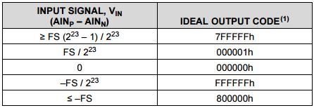

I don´t understand the formula for the LSB  that appears on page 46 of ADS1298 datasheet.
 (Table 13)
+VREF/(2^(23) – 1)
If the ADC has 24 bits of resolutions, and the more significative bit is for the sign of the signal.  The LSB should be +VREF/(2^(23))
why appears that "-1" there?
