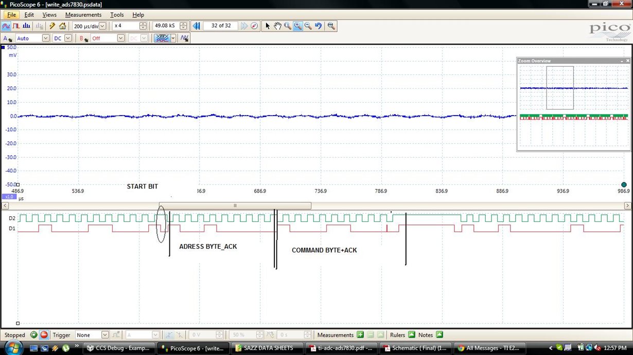

working on ADS7830 driver IC for ADC conversion.

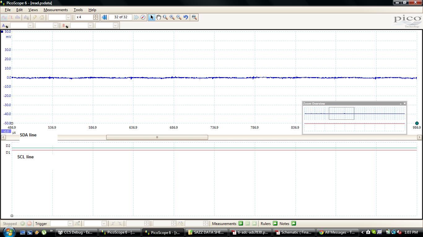

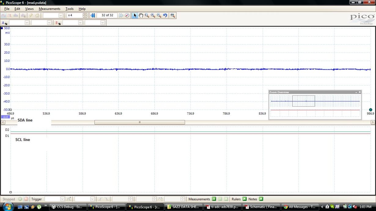

Using F28069 controller and I2C speed is standard mode(100KHz) , Only I2C write is working fine, getting ACK from ADS7830 but write andReading is not working always SDA is LOW(3.3v) and SCL HIGH(0V).
1.my slave Address is 0x48, means (According to Data sheet of ADS7830) The first five bits(MSBs) of the slave address are factory pre-set to 10010.The next two bits of the address byte are the device select bits, A1 and A0. Input pins (A1-A0) on the ADS7830 determine these two bits of the device address for a particular ADS7830.
Both A0 & A1 are grounded in my hardware.
2. Command BYTE value is 0x8C means Single ended I/P is High and POWER DOWN selection, Both PD1 and PD0 are high means Internal Reference ON and A/D Converter ON.
attaching what ever capture in writing and reading time. and also attaching code.
please help me to solve this problem.
