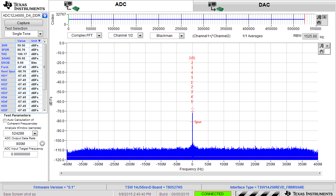

We have a customer that has noticed that the ADC12J4000 has a strong interleave spur at ¼ of the sampling frequency in DDC mode. In normal mode, the interleave spur can be reduced significant by enabling the timing calibration mode. Attached plot please find the acquired ADC spectrum from white noise input.
The test setup:
3.2GHz sampling rate
Decimation = 4
P54 = 1 (L = 4)
NCO = -800MHz (2.4GHz)
DDC gain off
Please explain the reason the DDC adds this spur.
Thanks for your help.

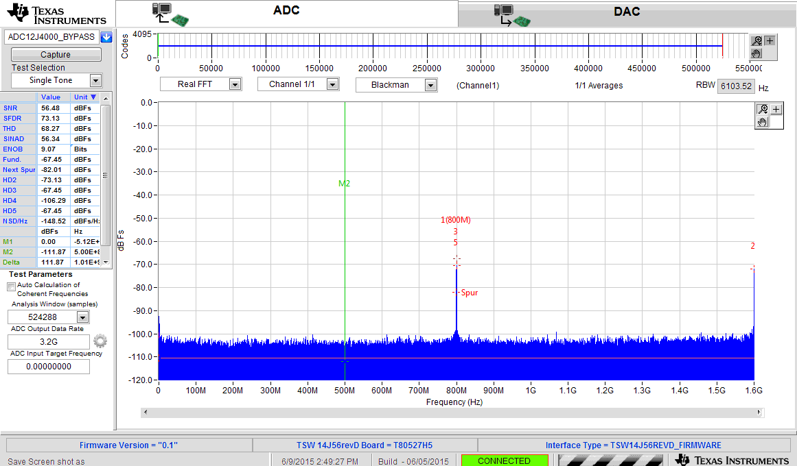

  • Hi John
    The size of the fixed frequency interleaving spur (not dependent on the input signal frequency) at Fs/4 shouldn't change significantly between DDC Bypass mode (no decimation) and the Decimate by 4 mode. I gathered some data at 3.2GSPS in both modes for comparison. See below:
    1) Decimate by 4 mode - Fnco = -800 (2400) MHz - Spur is at approximately -67dBFS.
    2) DDC Bypass mode - Spur is again at approximately -67dBFS.
    Is the customer plot with a signal applied? If so can you get them to re-collect data with no input signal so the fixed frequency spur at Fs/4 is the only peak visible?
    Jim B
  • Hi Jim,
    Thanks for your reply. You mention that the fixed frequency at fs/4 should not change significantly between DDC Bypass mode (no decimation) and the Decimate by 4 mode. We agree. We think there is some configuration that needs to be done in the ADC12J4000 that isn't being done. Can you look into this for us. Concerning having the customer take more data, I can certainly do this. We are not sure how to implement no input signal. I don't think you mean a floating input. How would you recommend implementing no input?
    John Wiemeyer
  • Hi John
    Is the customer using our evaluation tools (ADC12J4000EVM plus TSW14J56EVM) or their own hardware?
    If their own hardware, what FPGA are they using and did they base their design on the TI JESD204B firmware examples or from scratch using the FPGA vendor IP?
    On the ADC12J4000EVM the default configuration has the input signal applied to a single SMA connector. In this case the input can be left open (floating) or a 50 ohm termination can be applied to this port for slightly lower noise.
    If they have their own hardware they need to set the ADC inputs to 0V differential and at the center of the common mode range. If they are AC coupling to the ADC inputs they should be able to just terminate the input to the driving circuitry and the differential voltage will stabilize at 0V and the common mode will be biased by the internal ADC input termination connections.
    If they're using their own hardware, please send me the details of what configuration register settings they are writing for the two different modes they are using (DDC Bypass and Decimate by 4). I can check to make sure everthing necessary is there, and nothing extra or erroneous is being set.
    Jim B

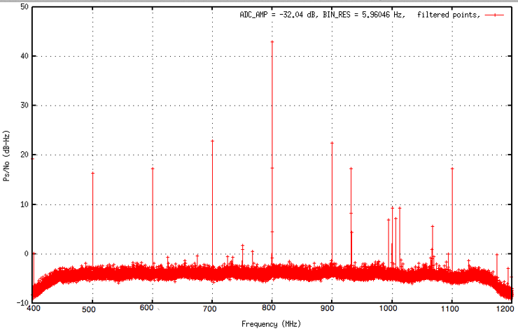

    Hi Jim,
    The customer is using their custom hardware based on the ADC12J4000
    The FPGA for both modes is Virtex-7 690T in FFG-1761 package. They develop the acquisition firmware from scratch using Xilinx’ JESD204 core.
    The resister settings for the Decimation 4 was attached in my original post.  Attached to this post please find the DDC bypass register settings.
    Please take a look at both register settings and let me know if you find any problems.
    John Wiemeyer
  • Hi John
    I haven't found anything obvious in the register settings for Decimate-by-4 mode that would cause higher than normal spurs. I do see the Calibration Status value = 0x0F for ADC#1. I expect that to be 0x0B for Foreground Calibration mode, which is what ADC#2 is showing. Can you get them to do another register readback and verify they are consistently getting that value for ADC #1?
    I'm happy to work directly with you and the customer to get this resolved. Email me to discuss this on Monday.
    Jim B
