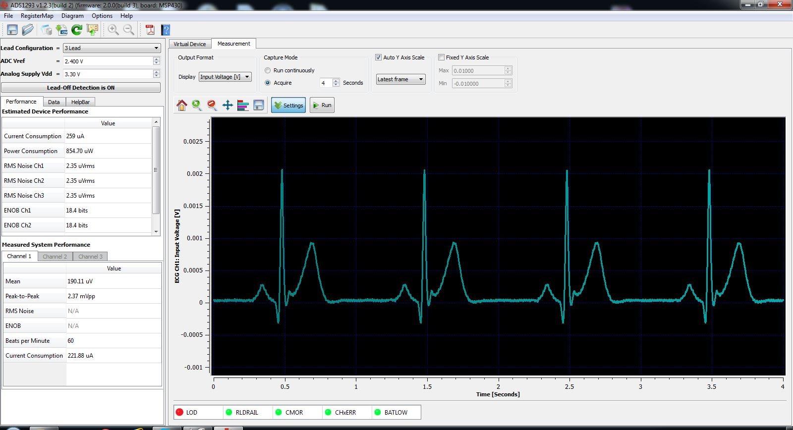

I am trying to create a design with just the RA + LA input.
Based on this thread https://e2e.ti.com/support/data_converters/precision_data_converters/f/73/t/407970
In the other pic I have shorted in4 to in1 RA.  I have also tried changing SELRLD to go to in1 with the same results.
Am I missing something?  Should something be hooked up to the RLDIN or RLDREF?
this is the baseline
