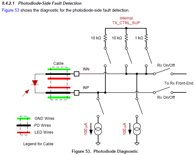

I found the following figure about Photodiode-Side Fault Detection.
Could you tell me the procedure of open and short diagnostic?
I understood the threshold of open fault resistance is >100kΩ and short fault resistance is <10kΩ, but couldn't catch the procedure.
