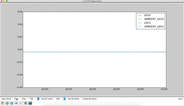

2. With the PD_ALM-workaround for synchronization, i have another problem with the measured signal. When placing the thumb on the SFH7050, the signal seems to go to a kind of saturation very early. The LED1 channel voltage has a maximum of ~33mV, LED2 channel of ~22mV. Changing Rf and Rg has no effect other then reaching the 'saturation level' faster or slower. In the short GIF i prepared you can see the placing and releasing of my thumb and the resulting limitation of the measured signal:
I am assuming that the TIA and/or stage 2 amplifier are malfunctioning. The reason for this assumption is the fact that i can measure voltages of 80mV in ADC_Bypass mode, when the amplifiers are decoupled. I think that this 80mV is a kind of floating drift voltage indicating no limiting malfunction of the ADC itself.
  • I have noticed that you have to click on the image to see the animated GIF.

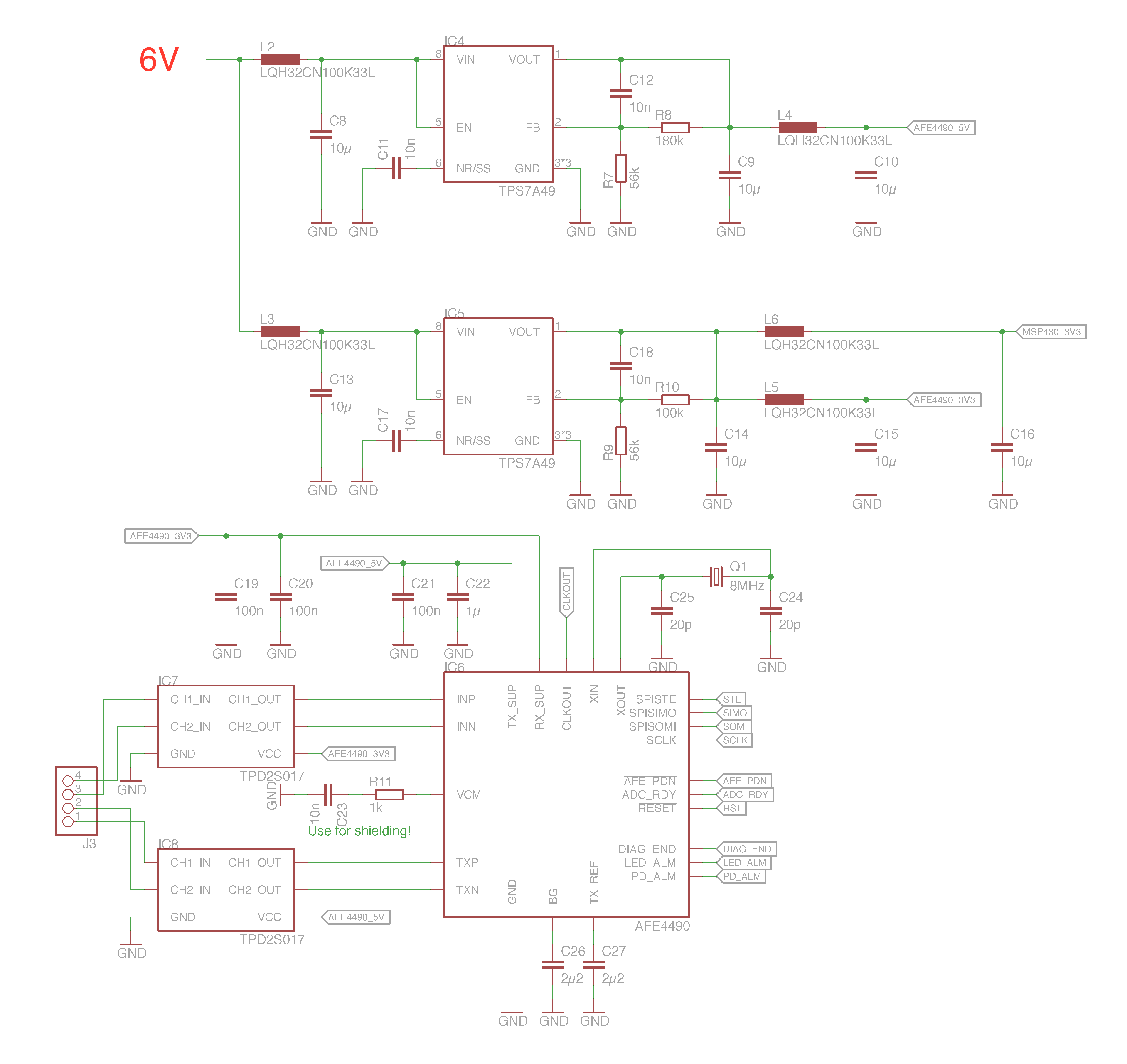

    Could you post your schematics and the AFE register configuration?
    Did you check the power supply currents? Are they within the specs in the datasheet?
    Did you run the diagnostic mode? Did any of the fault flags get set?
  • Hello Praveen,
    this is the relevant part of my schematics:
    My register configuration is:

    I have not measured the supply current yet, but will do it tomorrow.
    Reading of the fault flags gives me 0, so no faults at all.
    Thanks!
