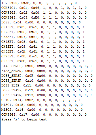

Then I made all the necessary connections(SPI , Reset, Start, DRDY) between Daughter Card and Arduino. The required power (3.3V and 5V , GND) are supplied from Arduino board.
When I run the program it shows the default register values correctly as follows. That implies the chip powered up correctly
Then I Modified CONFIG3, CONFIG1, CH1SET   registers to apply TEST signal to CH1 and take 250 samples.

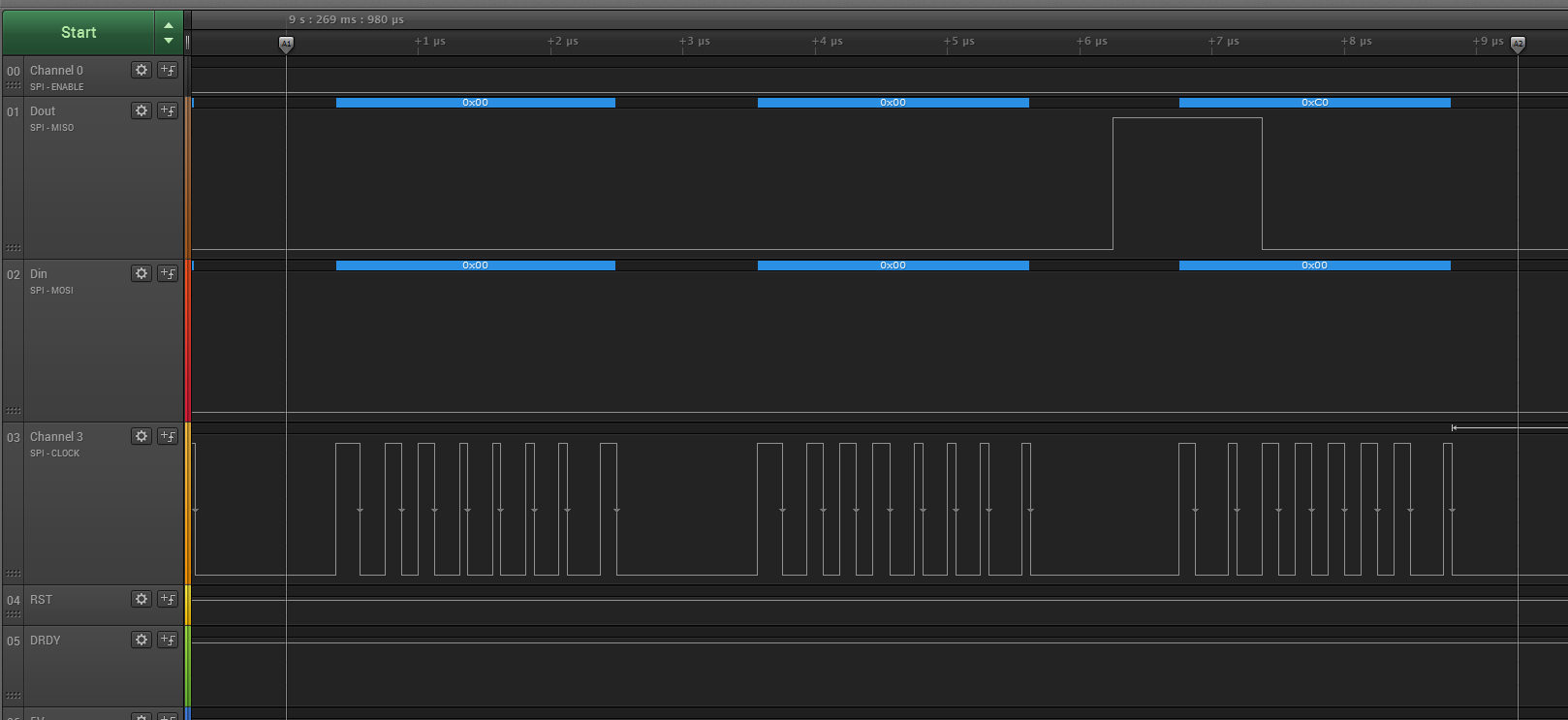

    Today I analysed SPI Lines using a logic analyser. The raw data observed from the SPI Analyser is same as the data I observe from the graph. i.e the error samples shown from the output  graph also shown in the raw data. I think this implies there is no data corruption after the acquisition.
    Here CH1 is in power down mode and acquired 200 samples and 187th sample has error value. The hex value of the sample is C0.
    This values shows in the SPI raw data observed from the analyser as follows
      ie. I have received corrupted data from the chip. then how to fix it?? When I connect the daughter card to MMBO board,  it works fine...
    I need to overcome this problem.. Brian Pisani  please assist me..

    Is that value 0xC0 the most significant byte of one of the channels? That value also happens to be the first byte one would expect to receive for the 24-bit status word. Also, looking more closely at the picture of your good data, the magnitude does not seem to be correct. Could you kindly take a picture of the entire transaction from when DRDY falls low to when the the final channel's data has been shifted out of the device?

  • Hi Brian,
    No. 0XCO is the Least significant byte out of three bytes of Channel as the image.  All the other data points of the channel is on Zero level except this point. The magnitude of the graph is different from 0XC0because C0 is converted to 32 bit sign value since data coming in 2's compliment format from the chip.
    since 0000C0 is positive value the signed magnitude is =192

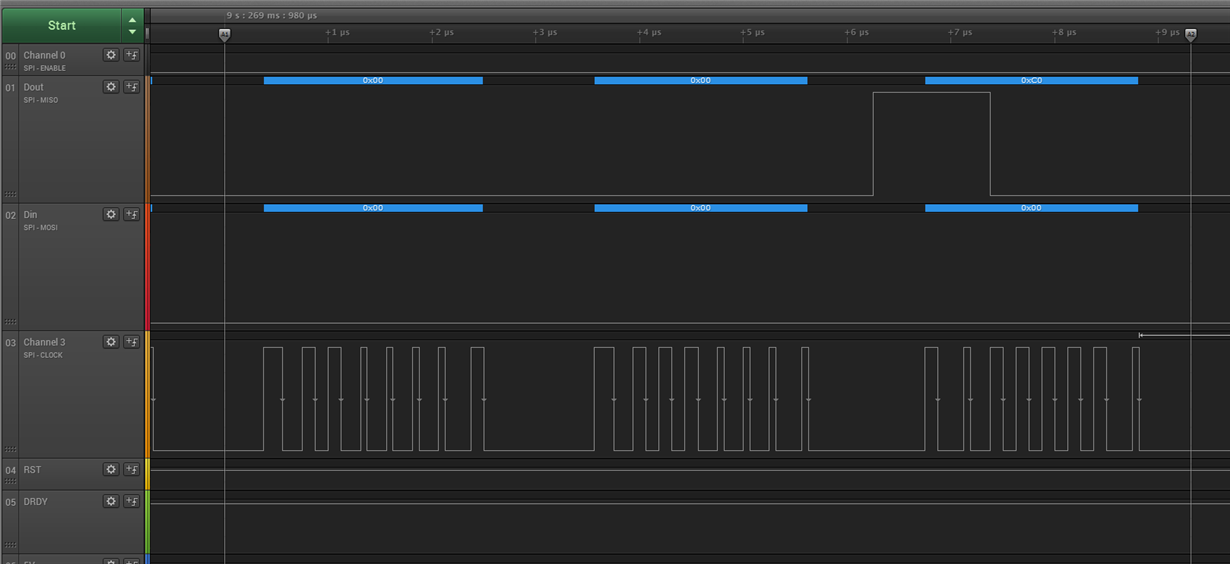

  • Hi Brian Pisani,
     This is the capture of effected sample ( Sample no 187)
    This is the capture of  unaffected sample( Sample no 186)

  • Hey Vibodha,
    That is very strange behavior. At this point I cannot explain why it is happening, but I think I understand what is happening. The value of 0xC0 on that seems to occur on the first channel is not trivial. As I mentioned before, 0xC0 is the first byte of the status word. In the case of sample number 187, look at the SPI transaction and imagine that second occurrence of 0xC0 is actually the beginning of the status word. If you do that, you's see channel 1 = 0x000000, channel 2 = 0x000000, channel 3 = 0x000000, channel 4 = 0xFEB548, channel 5 = 0xFEB401, channel 6 = 0xFEB47D, and channel 7 starts as 0xFE but is cut off by the end of the transaction.
    If you look at sample 186, you'll find the numbers I've just proposed to be very similar. I am not certain what could be causing this, but I have a theory. It is clear that something is causing the interface to reset during the middle of your sample 187 acquisition. There could be too much time between when DRDY falls low on sample 187 and when collection actually begins. If the the next DRDY falls low during acquisition, the device will just start to shift out the new data immediately. How much time passes between when DRDY falls low and SCLKs begin for sample number 187? We cannot see DRDY fall low on the logic analyzer, but perhaps it happens so fast that the analyzer misses it. The reason it would happen on only sample 187 is perhaps the delay between when DRDY falls low and when collection occurs increases a little bit every sample until sample 187 where it finally disrupts a collection.

  • Hi brian,
    The thing that you are saying can be true because only CH1,CH2,CH3 are in power down mode.. CH4- CH8 in test signal mode.. so in sample 187 , CH4 value is 0x00 which no true . Here is the graph of CH4 with square wave form and at sample 187 have unexpected Zero value..
     The time passes between when DRDY falls low and SCLKs begin for sample number 187 = 3.099 ms

  • Dear Brian,,
    Problem solved.....
    In my program I had sent each an every sample to serial port as it collected....This should have caused the delay for obtaining samples.....
    Now I collect all samples and stored in a 2D arry. then send data to the serial port... now there is no errors...
