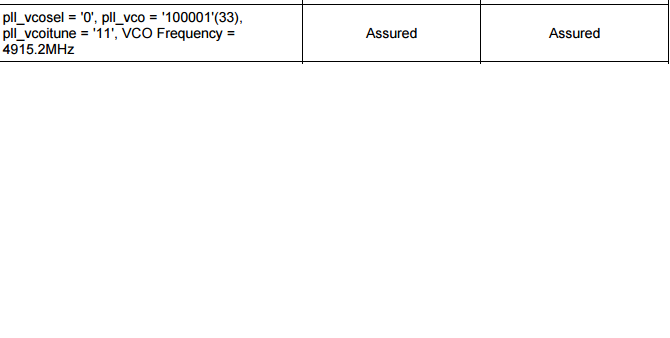

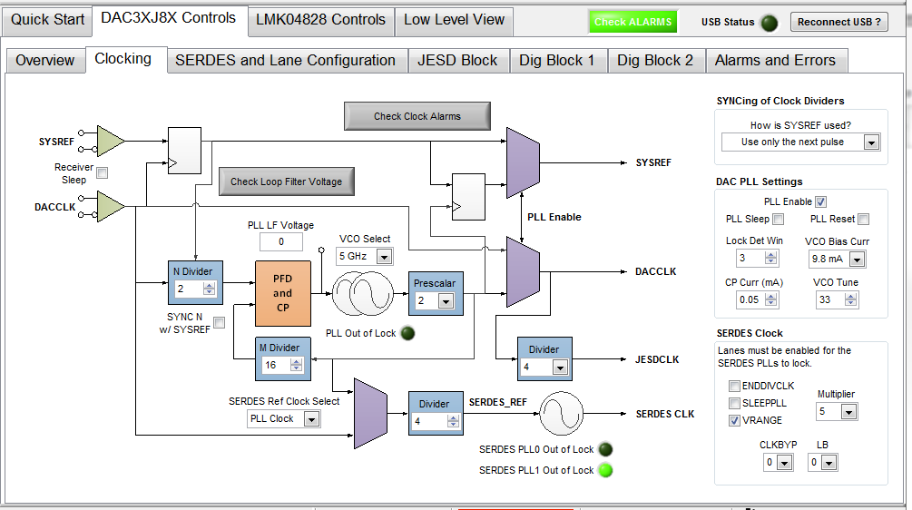

I have some trouble with the dac38j84 configuration :
When i read the config108 register, i get 0x0007 (i do not use the serdes block 1,) which means the serdes PLL lock fine, but not the DAC PLL.
I can"t find why the DAC PLL won't lock, do you have any idea why?
In attachment the registers as i write them.
The DACCLK is running at 307.2 MHz and i want to run only DAC A and B with a 421(LMF) JESD204B.
