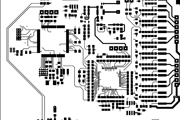

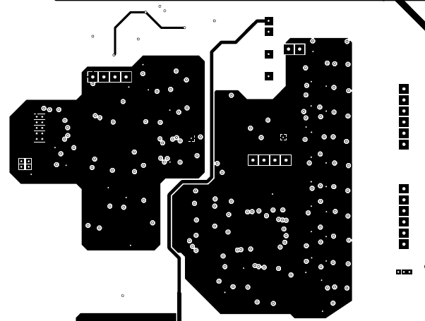

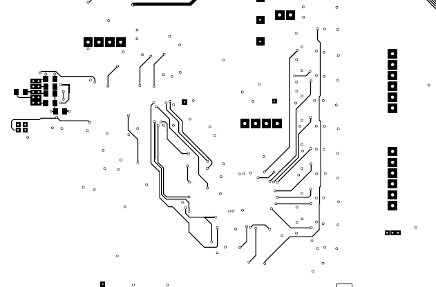

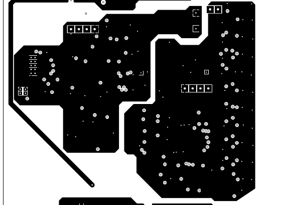

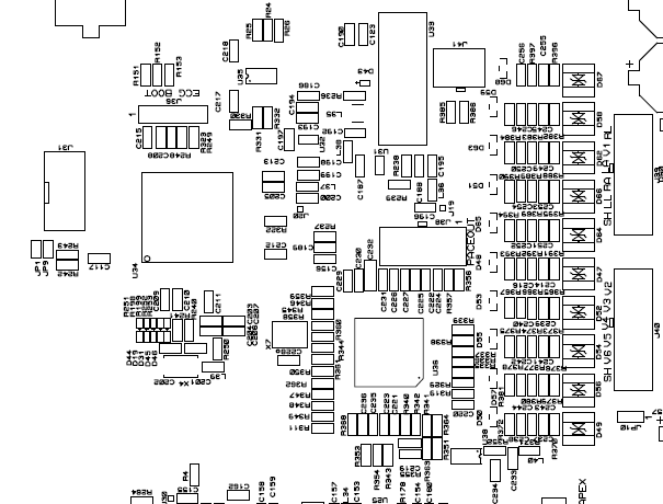

    for the layouts please check the pictures ;
