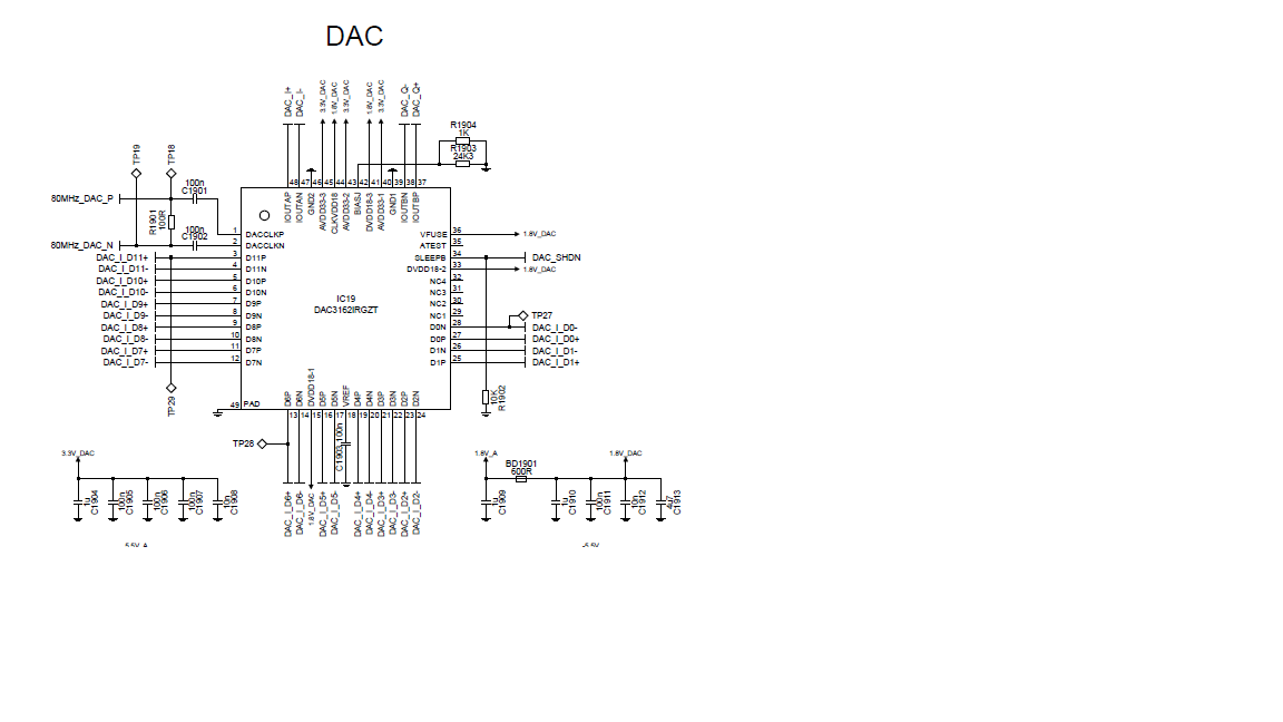

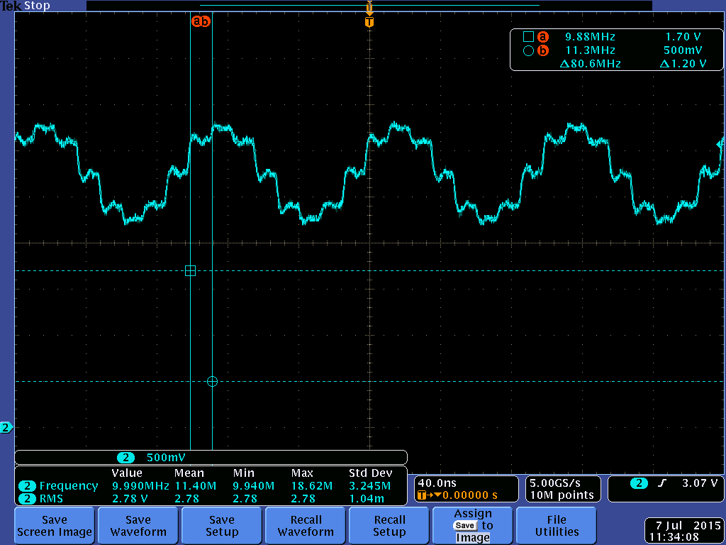

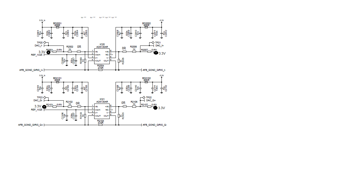

we try to produce a 10 MHz sin wave with a sampling frequency 80 MHz, we generate that sin wave with 8 sample points. the analog output of DAC3162 seems as stepped as in the attachment, i think we should make an interpolation filter, does this behavior of the dac is normal, can you check our schematics also. dac is controlled over a fpga, we are sure about the digital data we gave to dac.
