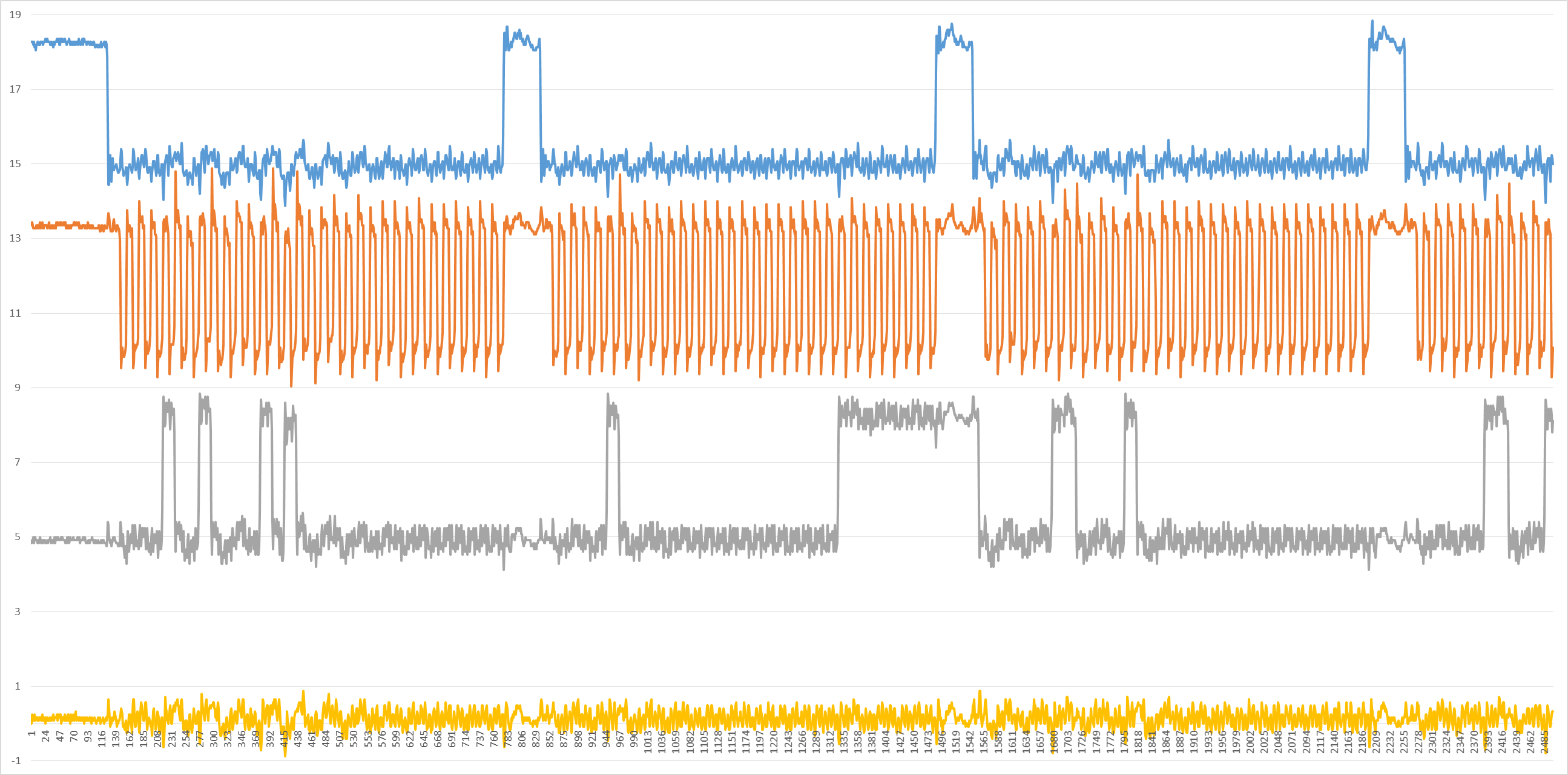

I'm driving a DAC8568 (A grade) with an FPGA (and therefore every change I make requires some tens of minutes for the firmware recompiling). I can't make it work and I don't understand why, so before starting a very time-wasting trial and error process I'm trying to get some hints. This is a typical trace with three commands:
Blue is SYNC#, orange is SCLK, gray is DIN and yellow is LDAC# (always low). The clock frequency is 25 MHz.
The first command is 0x090A0000 which enables the internal reference. This works, I can see the 2.5V pop out from the vrefout/vrefin pin.
The second command is 0x040000FF which should power on all the outputs.
The third command is 0x03080000 which should immediately set the first output to midscale, i.e. 1.25V for the A grade. After that there are seven similar commands for the other seven outputs (not shown).
Everything looks good, but all the outputs are stuck at 0V. Why?
Thanks!
  • Hi Larry,
    It looks like the codes you are using are correct.
    The signal does look very noisy, so I would suggest to slow down the clock to ~1MHz or less. This will allow us to determine if this is playing a role in the matter. If you have a few spare capacitors, it would be great if you could use them to clean the digital signals even further, specially SCLK. Some devices have sensitivity to SCLK overshoot and can sometimes interpret it as false edges.

  • Thank you Eugenio. I think that the noise is most probably picked up by the probes and the wires I'm using to sample the signals; the paths between the FPGA and the DAC are quite clean and short.
    However I've slowed down the clock to 5 MHz and apparently nothing changes. There is one interesting thing though: even the first command (reference power up) doesn't work all the times, in fact it works quite rarely. Most of the time the reference stays at 0V and this happens either at 25 MHz and 5 MHz. So you are probably right when you say that there is some electrical problem.

  • Never mind, Murphy stricked again. I was measuring the signals on duplicated pins of the FPGA (I've replicated them into some free FPGA pins connected to test points easier to access) and then I've forgot about this. Connecting the probes to the actual DAC pins, I've found out that the SYNC# signal is not driven and floats around 2V... probably this is why sometimes the first command (reference power up) was picked up, perhaps at system power up some parasitic capacitance was still "charging" and the voltage was slightly under 2V.
    In the past days I've made some veery bad experiments and probably I've zapped the FPGA pin. I will fix this relocating the signal to another pin and then I will report if it works, just to close the status of this thread.

    I have fixed this by relocating the signal to another pin and now everything looks fine.
