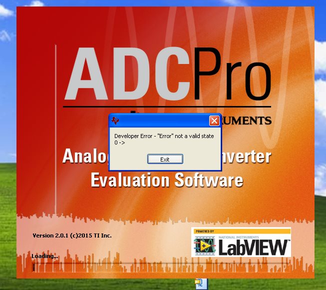

I'm trying to install ADCPro on my computer and I'm getting a weird error pop-up when I try to launch the program.
I know that the software is only supported on Windows XP with SP3 installed, which is what I am using. Any input would be highly appreciated.

  • Hi Joseph,
    I'm trying to utilize the ADS1115EVM in conjunction with the ADS1115EVM-PDK. I installed the corresponding drivers as well. ADCPro doesn't seem to properly load, however.

  • Joseph,
    Sorry for the late response. I'm actually using somebody else's old computer, but I don't believe ADCPro has ever been installed on this machine before. The version of LabView installed on here is v6.0.

  • Joseph,
    The directory that you asked me to check did not exist on my computer. However, I did check C:\Program Files\ADCPro\saved and there was nothing in there.
    I've only tried to run the .exe that came with the installer.

    options.ini exists.
    All folders (with the exception of evm) exist.
    I have attached adcpro.ini with this response.
    I appreciate the help you folks have been providing me.
    Josh

  • Hi Greg,
    I had edited the adcpro.ini file per your suggestion and the error still persists. I had originally obtained the software via the link you provided, but I performed a clean reinstall to no avail.

  • Hello Josh -
    OK, thanks for trying.
    One more thought...the DataDir path from the file above (or from your current adcpro.ini file), does it exist? In other words, can you navigate to that directory? If not, try changing it to an existing directory and see if that helps
  • Greg,
    It worked! Thanks for taking the time to figure this one out, I seriously appreciate it.
