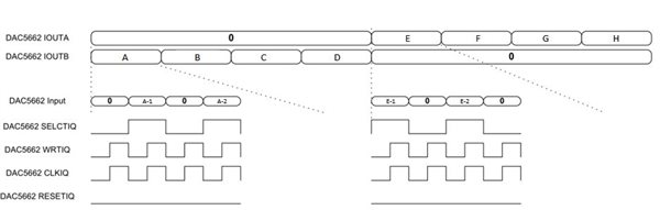

The customer would like to control the IOUTA and IOUTB output as the attached image.
I think that we can use DAC5662 on this operation by the interleave mode however, could you please check it?
Mode is interleave mode.
When IOUT B has output, the IOUT A output is 0.
And IOUT B output is 0 when IOUT B has output.
RESETIQ is fixed to L.
My understanding is that we can select the output channel by SELECT IQ and WRTIQ and CLKIQ is shared with IOUTA/IOUTB.
