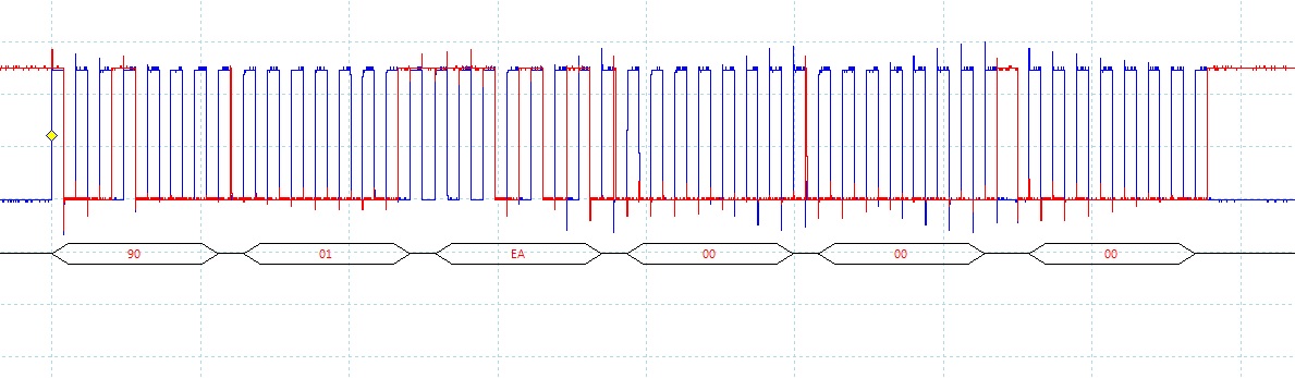

read SPI:
0x90
0x01
0xEA
0x00
0x00
0x00

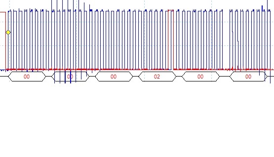

MOSI:
MISO:
The MISO Value is glued to 02, it does not change at all if the resistor to measure changes.

char SPIreadExample(void)
    SPI_PORT &= ~(1<<SS);    //chip select
    uint8_t buffer2;
    //uart_puts("0 ");
    //send Instruction Byte 1
    //while(!(SPSR & (1<<SPIF)));
    // Byte 1: Instruction Byte 1
    SPDR = 0x90;
    //uart_puts("1 ");
    //Byte 2: Upper Adress Byste
    SPDR = 0x01    ;
    //uart_puts("2 ");
    //Byte 3: Instruction Byte 2
    SPDR = 0xEA;
    //uart_puts("3 ");
    //Byte 4: Data Bytes (dummies if receiving)
    SPDR = 0x00;
    //uart_puts("4 ");
    SPDR = 0x00;
    //Byte 5: Data Bytes (dummies if receiving)
    buffer2 = SPDR;    // read 1. response byte
    uart_putc(buffer2);
    SPDR = 0x00;
    //uart_puts("5 ");
    buffer2 = SPDR; // read 2. response Byte
    uart_putc(buffer2);
    SPI_PORT |= (1<<SS);
    //uart_puts("5\n");
    return buffer2;

My problem is, that I do not get any significant MISO signal, it just does not read the resistor I placed on CH 0, differential.
My first question is, did I do any obvious mistake? Can anyone help me with that? Is there any full example to read DC on CH0.
The second question ist, is it possible to just read a resistor with one end attached to GND?
