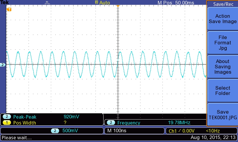

I have purchased the TSW1400 and DAC3482EVM evaluation kits and started testing using the TI provided tools and firmware.
I am not feeding the external clock for DAC3482EVM instead using 19.2MHz on-board clock.
The HSDC pro tool generates a simple sine wave of 10MHz frequency at 250MSPS rate.
But in the DAC output  I am observing sine wave of around 20MHz with 920mVpp. [The gain is set to 10(20mA full scale current).]
Can you check the attached DAC-EVM register settings and let me know which settings got  missed.

    Most likely the frequency tone error is due to the tone generated by HSDC PRO is sampled at 250MSPS but the actual DAC operating data rate is at something else. Please advise that if you had configured the DAC3482EVM with 491.52MSPS input data rate, 2x interpolation, and 983.04MSPS of DAC rate after interpolation. This will cause the frequency error.
    You may want to change the data rate setting on your HSDC PRO and regenerate the tone at 491.52MSPS.

  • Hello Kang,
    Thank you for the suggestion. I will try this and update you.
    Hariprasad Bhat
  • Hello Kang,
    I continued my testing by setting 491.52MSPS at HSDC tool and configuring DAC in x2 mode.
