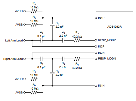

  • Thanks. I have a problem, with respiration meassurement, I get only noise.
    Configuration for ADS1292R:
    ADS1292_WriteRegister(ADS1292_REG_CONFIG1, 0x00);
    ADS1292_WriteRegister(ADS1292_REG_CONFIG2, 0xA0);
    ADS1292_WriteRegister(ADS1292_REG_CH1SET, 0x60);
    ADS1292_WriteRegister(ADS1292_REG_CH2SET, 0x80);
    ADS1292_WriteRegister(ADS1292_REG_RESP1, 0xD6);
    ADS1292_WriteRegister(ADS1292_REG_RESP2, 0x81);
    ADS1292_WriteRegister(ADS1292_REG_RLD_SENS, 0x20);
    ADS1292_WriteRegister(ADS1292_REG_LOFF, 0x10);
    ADS1292_WriteRegister(ADS1292_REG_LOFF_SENS, 0x00);
    ADS1292_WriteRegister(ADS1292_REG_LOFF_STAT, 0x00);
    ADS1292_WriteRegister(ADS1292_REG_GPIO, 0x00);
    Schematic:
    I connected oscilloscope to RESP_MODN and RESP_MODP and got square wave.
    What could be wrong ? How I can check it ?
  • Hey Vic,
    Your register configurations are correct. You should expect to see a 32 kHz, 2.42 V square wave between RESP_MODP and RESP_MODN. You should see an attenuated version of that signal at IN1P and IN1N. The magnitude of attenuation should vary with respiration. How are you attempting to measure it? Are electrodes connected to a patient simulator? You can calculate the baseline body impedance by dividing the DC component of the output voltage by 30 uA.
    Brian Pisani
