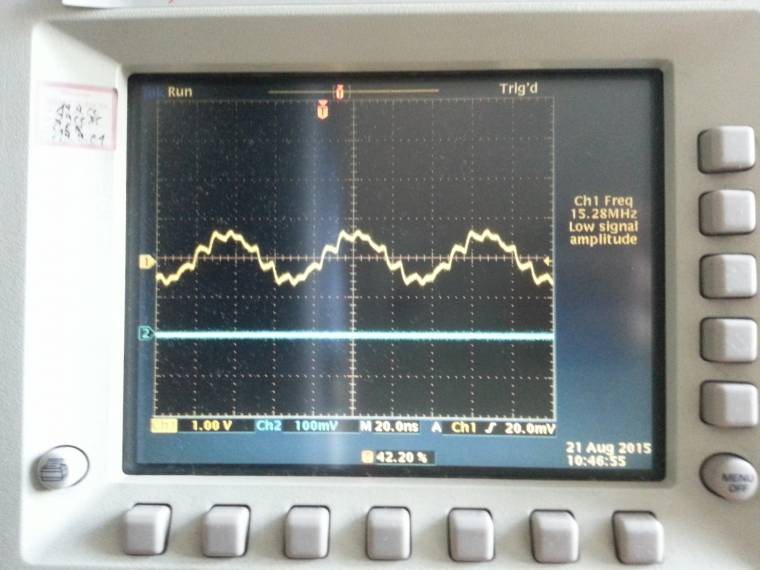

    I have one more question. I attached a picture of the sine output I captured with scope. Why isn't the sine wave smooth(er)? I'm sending 8 samples on 122.88 MHz, so I get a ~15 MHz sine wave. The samples are the following:  0x0, 0xA53E 0x8001, 0xA53E, 0x0, 0x5A82,  0x7FBF, 0x4A82.

  • Hi Ana,
    you may notice that there are 8 steps on your waveform. This is mainly due to the DAC's sample and hold circuit. To get a smooth output waveform, you will need to attach a low pass (anti-aliasing filter) or use a higher sample rate after interpolation.
    See below app note for detail
    www.ti.com/.../slaa523a.pdf
