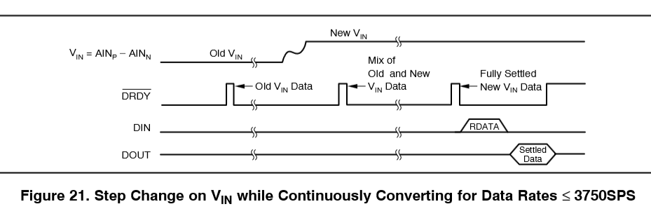

From Page 22 in the ADS1256 datasheet:
“If there is a step change on the input signal while continuously converting, performing a synchronization operation to start a new conversion is recommended. Otherwise, the next data will represent a combination of the previous and current input signal and should therefore be discarded.”
However this note on discarding interim results contradicts the very idea of the continuous measurement. Obviously the user is applying this mode when he is interested in the timely behavior of the input signal. Hence he is not in the position to “restart” the measurement if there is a change on the input signal.
More importantly the sine wave should not present any sort of “step change” for the ADC.

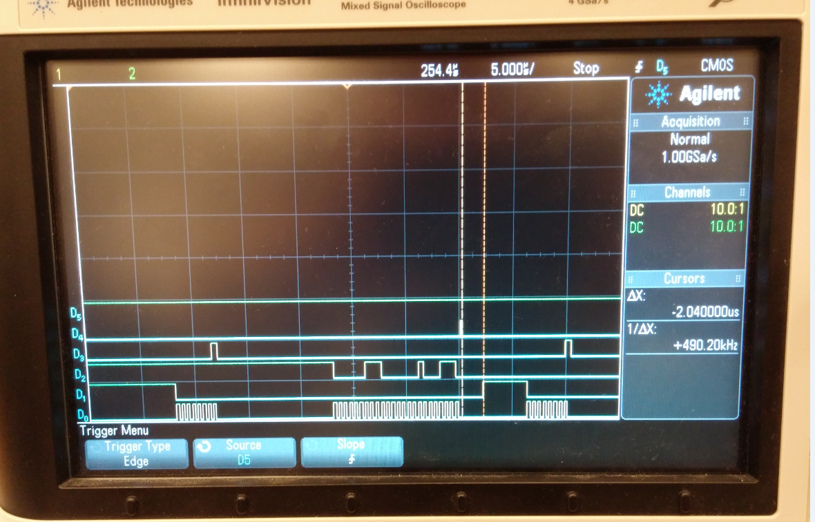

  • Hi Chris,
    Thank you for the fast response.
    We are interfacing the ADC with an FPGA, so the SPI timing (POL and PHA) is handled by our HDL code.
    SCLK  = 2Mhz, fCLKIN = 7.68Mhz.
    We are waiting for the DRDY falling edge, sending a read command, waiting for t6, receiving data.
    We double checked the SPI timing on the scope. From the datasheet we were expecting the DRDY rising edge exactly after the LSB of the data transfer, as shown here:
    Using the scope we found out that this occurs 2us after the LSB is transmitted.
    D4 - transfer done
    D3 - MOSI  (read command)
    D2 - MISO  (read data)
    D1 - DRDY
    D0 - SCLK
    We adapted our timing based on these observations and now the spikes disappeared.
    Probably we were reading out the conversion results to soon (not meeting t6 timing), which caused to have a mix conversion result from prev and actual data. ... at least this is the best explanation we have.
    Anyhow, it is working now, thanks for the hints.
