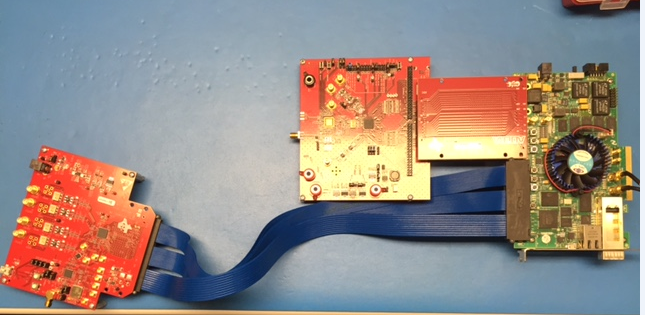

  • Larry,
    DAC3482EVM also have the updated connector. We have checked the mechanical fit of the ADS4249EVM + DAC3482EVM to the Stratix V board, and noticed that the two boards cannot fit simultaneously due to the board size (see picture below). Since you are doing an repeater experiment, this set up may be critical.
    For the ADS4249EVM, you will need to order the  ADS4249EVM + HSMC_ADC extender card.
    For the DAC3482EVM, you will need a extension cable from Samtec. The current Samtec extension cable has two round slots at the connector intended for additional bolts. The round edge protrudes slightly, and making the extension cable next to the hsmc-adc bridge a tight fit (they do fit though). Our tech is looking into if there are other extension cables from samtec that does not have the protruding slots.

  • Kang
    Great, I ordered the boards today.  Thanks for the detailed information on the mechanical fit and the picture.  I have the HSMC to ADC bridge and the Samtec HSMC cables but haven't been able to plug them into the Stratix V boards yet.  It was very helpful to see the picture with the exact setup I am putting together.

  • Hi Kang,
    I've made some progress on this project and have been able to implement the repeater design using the TSW1400EVM along with the ADS4249EVM and the DAC3482EVM.
    No I'm attempting to set things up as shown in the picture above that you sent. I have ran into a problem though, it looks like the HSMC B port which the ADS4249 and the ADC bridge are plugged into the photo is not the HSMC LVDS standard but rather the HSMC QDS standard which supports external memory devices or single ended CMOS interfaces. The HSMC A port that the DAC 3482 is plugged into through the cable above is the standard HSMC LVDS port.
    Now I'm looking for a way to connect both the ADS4249 and the DAC3482 evaluation boards to the Stratix V development kit to implement the repeater design and a simple radar application. One option might be to run the ADS4249 in CMOS mode and connect it to the Stratix V development boards port B. An issue I see with this is that the ADC bridge is designed for LVDS signals with the clock and data lines closes routed in pairs. Do you think given that routing I would have issues connecting the board in CMOS mode and running at 250MHz as in the repeater design?
    Another option might be to try and come up with a setup to connect both boards to the HSMC A port which is LVDS. This might work since the ADS4249 only connects to the receivers on the even numbered side of the connector while the DAC3482 only connects to the transmitters on the odd numbered side of the connector. Do you know if it would be possible to order a cable from Samtec that splits those signals out into to two connectors? Looking at the extension cable it looks like the odd and even signals uses separate cables between the connectors?
