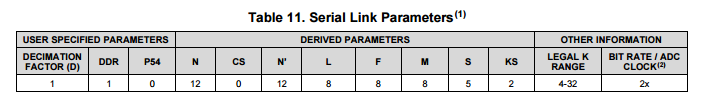

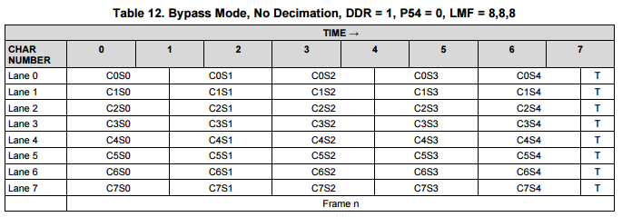

  • Hi Jim,
    Thank you for your support.
    I understood.
    Again, I request the following.
    Customer is using ADC12JxxxxEVM.
    Fs(Devclock)=3.2GHz.
     TRF3765 outputs 3.2GHz which is supplied to ADC12J4000 directly as device clock.
     LMH04828 outputs SYSREF clock which is set by GUI to ADC12J4000.
     LMH04828 is inputed 3.2GHz clock from TRF3765.
     Condition is the below.
    Could you inform me the hardware changes and  give me modified file, please?
    Is there other necessary information?
    I think SYSREF clock can change on GUI. Is it correct?
    Shimizu
  • Hi Shimizu
    The hardware will not need to be modified for that configuration.
    The only changes required are to update the ADC12J4000 configuration to enable the SYSREF receiver and processing, and the LMK04828 configuration to enable the ADC SYSREF output. The two files attached below have the necessary changes.
    LMK04828_DB1_Fs_3500Msps EN ADC SYSREF.cfg
    ADC12J4000_DB1_DDR_EN_SYSREF.cfg
    Copy these files to the following folder location: C:\Program Files (x86)\Texas Instruments\ADC12J4000EVM GUI A\Configuration Files
    These files can be used two different ways. The ADC can be configured normally for 3200 MSPS onboard clocking, with DDC Bypass mode and then these updated files can be loaded one at a time using the Load Config button on the Low Level View tab.
    The other option is to use these files in place of the ones that normally get loaded. To do this first rename the original files, adding a .bak suffix.
    ADC12J4000_DB1_DDR.cfg becomes ADC12J4000_DB1_DDR.cfg.bak
    LMK04828_DB1_Fs_3500Msps.cfg becomes LMK04828_DB1_Fs_3500Msps.cfg.bak
    Then rename the new files to the following:
    ADC12J4000_DB1_DDR_EN_SYSREF.cfg becomes ADC12J4000_DB1_DDR.cfg
    LMK04828_DB1_Fs_3500Msps EN ADC SYSREF.cfg becomes LMK04828_DB1_Fs_3500Msps.cfg
    Now when the board is configured for 3200 MSPS onboard clocking in DDC Bypass mode, these new files will automatically get loaded.
    With the new files, the ADC SYSREF is continuously active.
    Jim B
