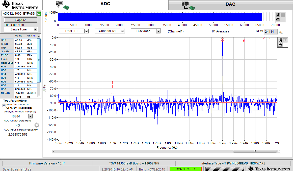

    thank you for your reply. For the attached screenshot, I used :
    - Fs : 4GHz
    - Fin : 2 100 006 103.52Hz, because I use a 2.05-2.150 GHz pass band filter to remove the signal harmonics.
    - FFT length : 8192 samples

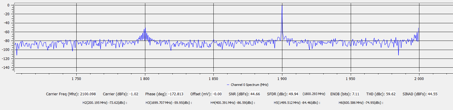

    Problem at 1-dBFs
    Zoom on the problem zone

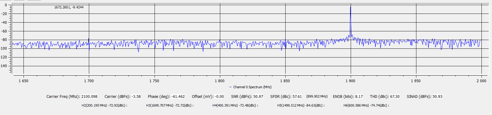

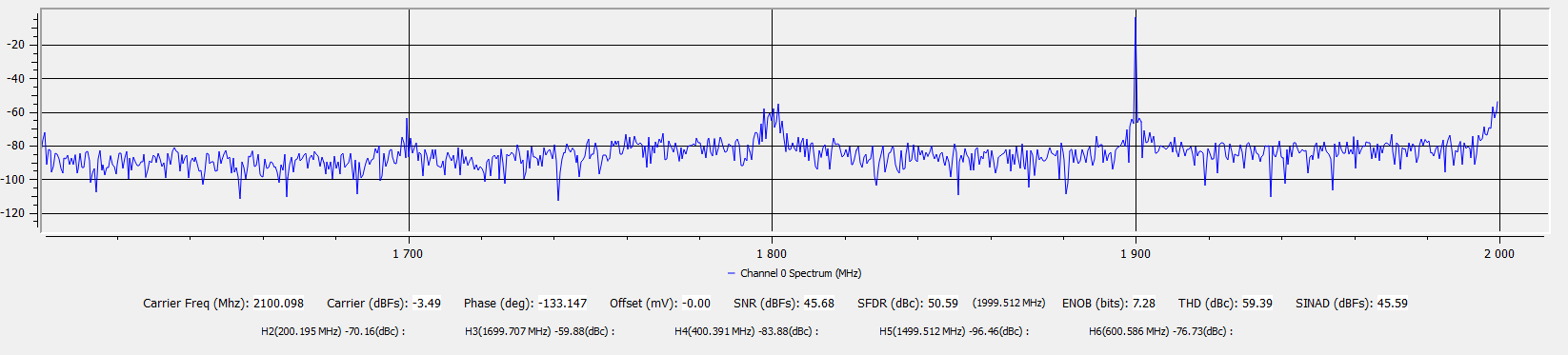

    problem at -3.5dBFs zoomed
    problem disappeared at -3.6dBFs

  • Hi Manuel
    I haven't been able to replicate those spurs at 100 MHz offset in the default EVM configuration. I was able to see a small spur at 1800 MHz when I disabled the JESD204B link scrambling feature.
    Is the link scrambling feature enabled in your design? Scrambling is included to reduce any effects of repeating pattern data causing coupling to other elements in the system, etc. If this is not enabled that might be the cause of the spurs you see at large signal levels and particular frequencies. If scrambling is enabled then the data link is likely not that cause of the problem.
    Another potential coupling path would be from the ADC power supplies into the analog input path, or clock path. These are also potential paths for unwanted noise to affect the converter performance.
    Jim B
