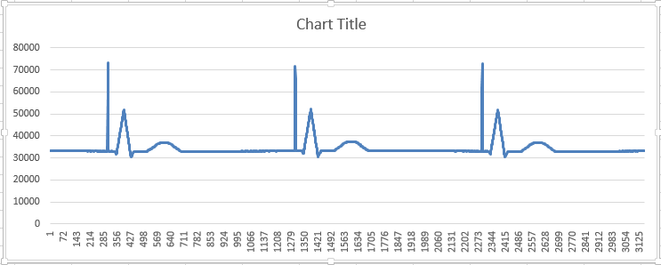

I am trying to make hardware pace detection work with ADS1296R.
I am using a custom board with ADS1296R and MSP430BT5190 on it and a simulator that can produce a pacer signal of width up-to 2ms and amplitude up-to 5ms
On ADS1296R following are the register configurations
0x0F, //gpio, to make them input pins
0x09, //pace. 4th channel routed to TESTP_PACE_OUT1 (Pin E3 on ADS1296R)
I am feeding this TESTP_PACE_OUT1 to the hardware pace detection circuit. I have followed the reference design for the circuit from "TI Precision Designs: Verified Design, Hardware Pace using Slope Detection" by Tony Calabria.
When i observe GPIO4, latch is not going high.
So first of all,
How do i make sure that i am getting a PACER pulse at TESTP_PACE_OUT1 ?
When i observe this pin (E3 on ADS1296) on CRO i am seeing a noisy sine kind of wave, the same trend continues on output of differential amplifier.
What might be going wrong?
