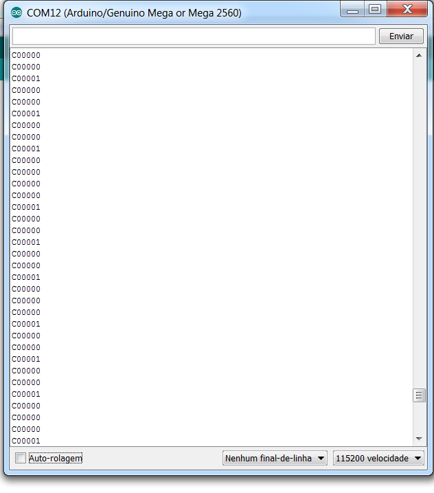

Another thing that I noticed is that my status register often gets one bit that it shouldn't (Should stay at C00000, but sometimes it becomes C00001).

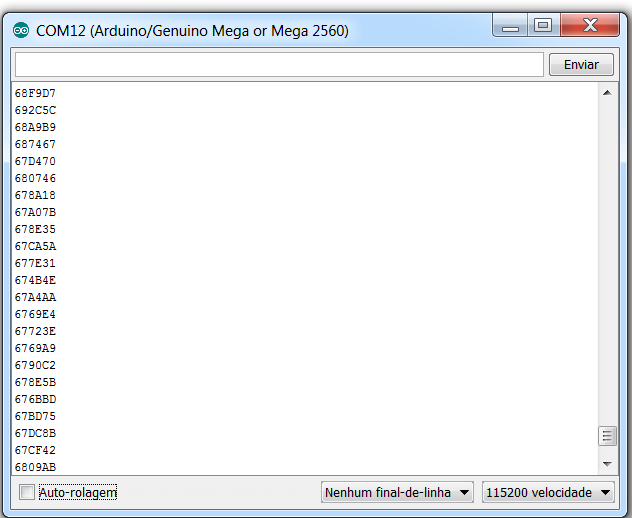

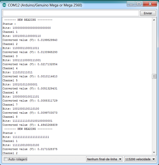

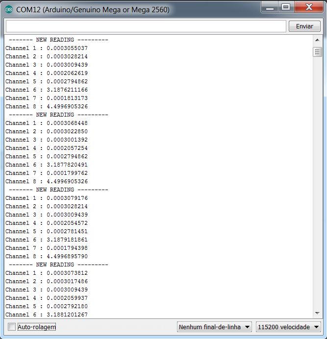

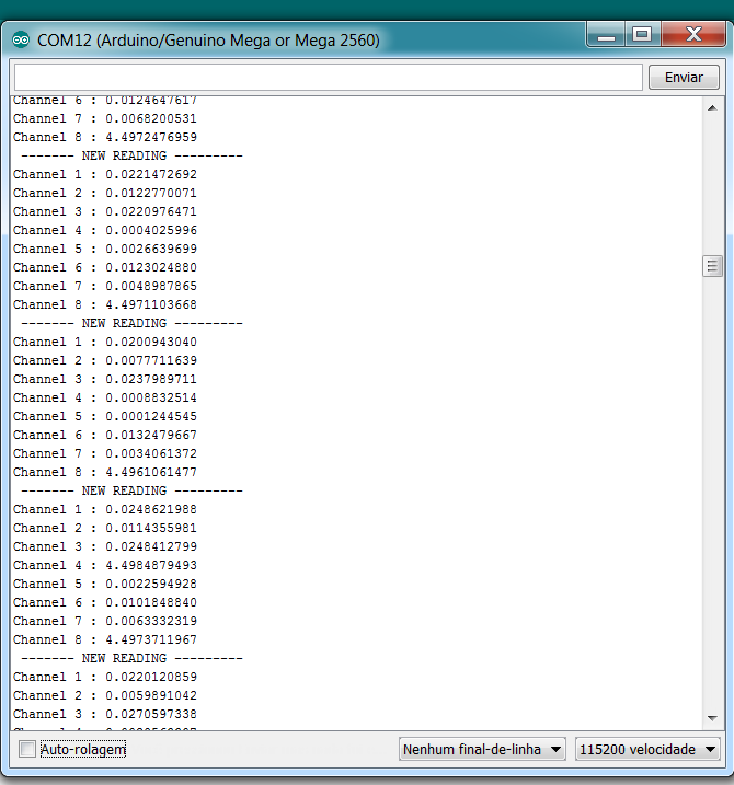

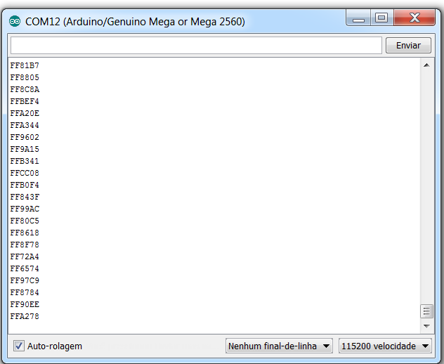

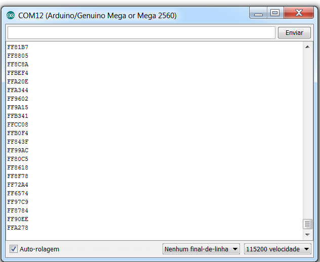

Here are some screenshots using arduino serial to get the values. I actually get STATUS + 8 channels data, that is working fine.
Each reading happens at each millisecond.
But on the screenshots only printed channel 1.
Status register:

So... I am really lost here. I've tried lots of different schematics, but I always get values that are waaay to high!
I've already checked thousands of times, and my internal reference is 4,5V, DVDD 3v and AVDD 5v.
Could it be power line noise (considering I am using no batteries at all?) or faulty VCAPs ?

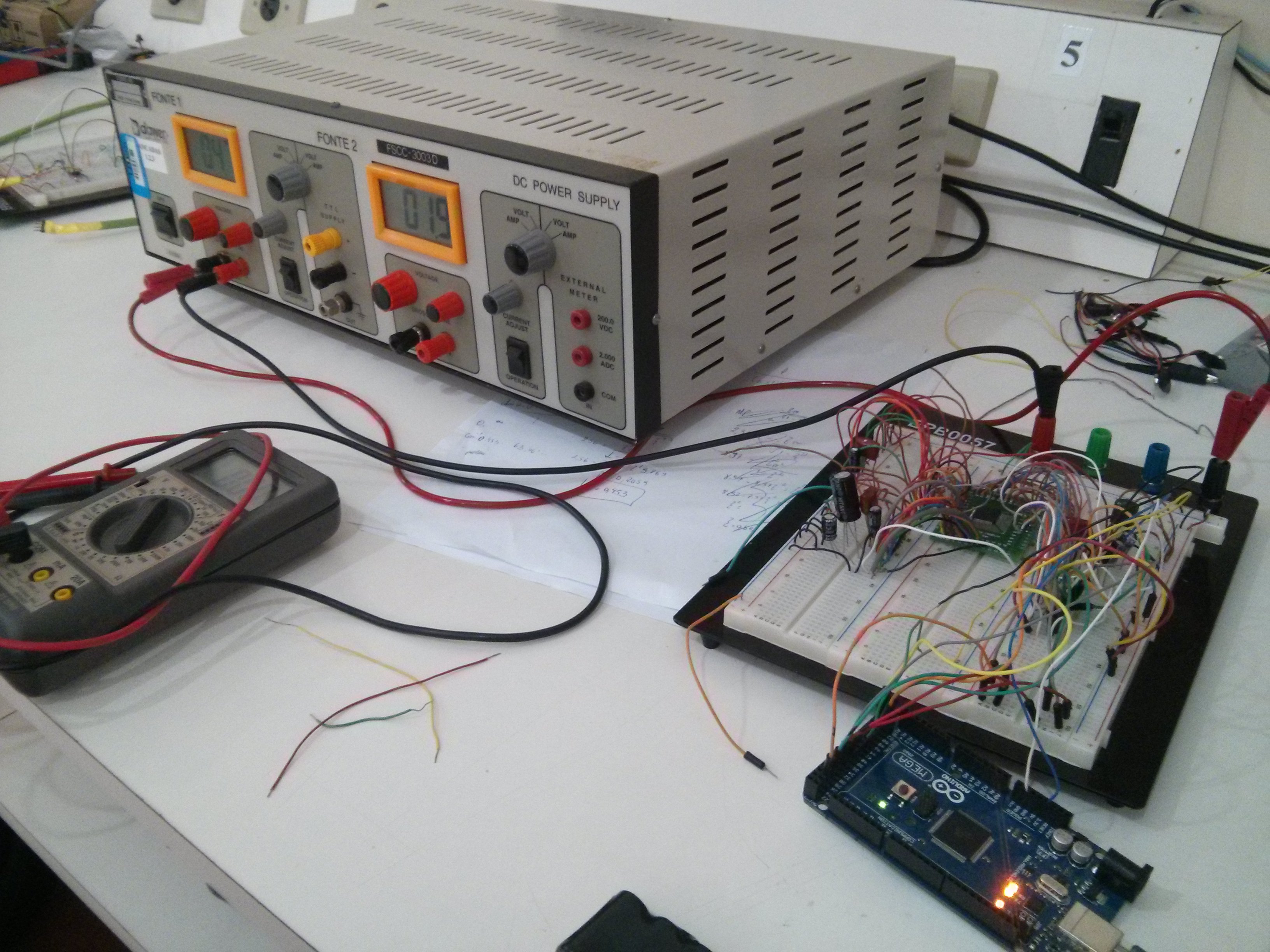

Here is a screenshot of my setup (I know it isn't the more appropriate approach, but this is just a chip validation):
  • Hey JJ,
    The part will return channel conversions in two's complement binary. Two's complement words with leading 0xF's are generally small negative values. Have you accounted for this?
    Brian Pisani
  • Thanks for answering Brian!
    I remember I toyed around converting the readings from 2's complement and I had no success.
    I did it again just to be sure and maybe that's the problem.
    But I am not sure if I am doing it right:
    First, I invert all bits of my data. Then I add one bit to it.
    And finally, considering the type of data is long, I subtract 0xFF000000;
    Here's the part of my code that deal with this matter:
    channel[i] = ~channel[i];
    channel[i] = ( channel[i] | 0x00000001 ) - 0xFF000000;
    And then I just have to multiply the value by 4.5/(2^24).
    I gave it a shot and I am still unsure if it is correct (I am getting very low values now, but I can't measure a 2.5V battery I have... the readings are not right at all). I am still toying with it.

    So, these are the readings I get in all channels (input short):
    Some things I noticed:
    Channel 8 NEVER has a value of 0.xxxx.
    Sometimes other channels get a 4.4xxx value.

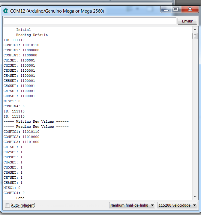

  • Here are register values, just in case.
    Btw, arduino won't display MSBs of a word if they are 0.

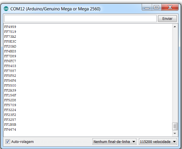

  • Also, I don't get why I was having "0xFF..." values (as I shown in the first post of this topic), considering I am using unipolar supply.
    According to the datasheet, anything greater than 0x800000 is negative!
    Isn't that right?

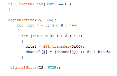

  • Hey Brian, sorry for taking so long to reply.
    This is the part of my code used to acquire data:
    If you were talking about screen capture of a scope or something, I don't have it right away, but I am gonna try and see if I can make it work.

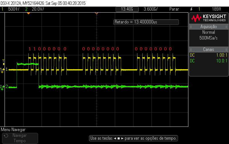

    edit: I managed to get the scope working. Pictures are in the next page.

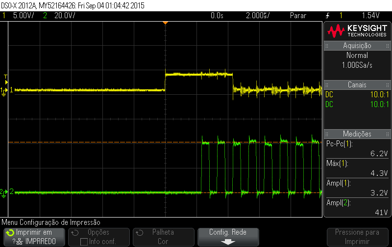

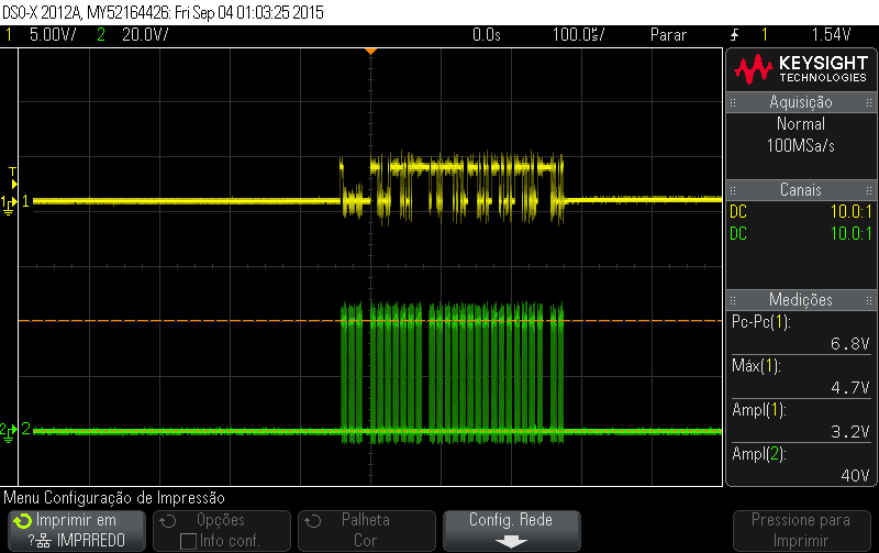

  • Hello again Brian,
    I managed to get the scope working. Unfortunately since I don't have any kind of connector, I am using the probes (only 2 channels available) in order to get the signals.
    Yellow line - DOUT
    Green line - SCLK
    The following image shows a whole 216 bits aquisition
    The following image shows the very beggining:

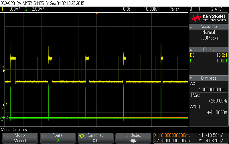

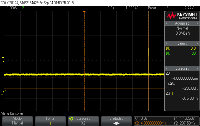

  • And here is my DRDY, working as 250 SPS (as set in the register)
    And here is my DRDY when actually converting (green line is SCLK)
  • Hey JJ,
    I was hoping to see the individual bits of conversion data coming from the device. It possible to capture that?
    Brian

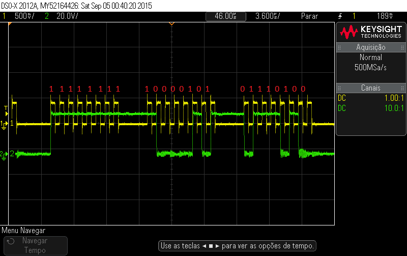

  • Hey Brian,
    The first two pictures I posted on this page show the individual bits coming from the device (DOUT). Isn't this what you were hoping to see?
    If not I'm sorry, can you explain in other words what you want?
    I can capture right away (scope and arduino serial monitor if needed).
    Here is the individual bits of each channel in arduino (input short mode):
    First picture: RAW BITS
    Second picture: BITS converted FROM 2's complement.
  • Hey JJ,
    I was hoping to be able to read the individual bits of one of the channels' conversions to ensure the bits are coming back as your program is reporting. Perhaps do something similar to your first image but zoom into one of the channel's data.
    Brian
  • Hello Brian!
    Ah I see...
    So, I checked and the bits coming from DOUT is actually the same I can read from Arduino serial monitor.
    Conversion start: (status)
    The very next 24 bits (channel 1)
    And Arduino serial monitor
    As you can see, Status and Channel 1 are correct (I didn't check the other channels).
    Do you think I should check all 216 bits as well just to make sure?

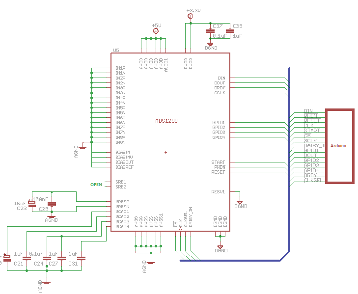

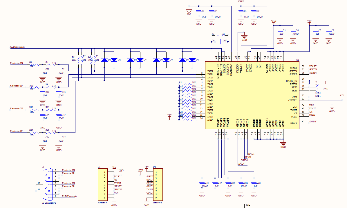

  • Hey JJ,
    I'd like to see your schematic when you get a chance to post it.
    Brian Pisani
  • Hello Brian,
    So here is my schematic:
    I may have good news though: After checking the connections, I noticed that VREFN wasn't grounded.
    After grounding it, things looked better.
    Now I am able to measure the input voltage with more accuracy. The input short mode looks more stable, also in normal input mode grounded inputs
    gives me a very low voltage (0.000... V). And when I try to measure a 2.5V battery I have I get a 3.18V (at least it is stable).
    As you can see now things are looking better.
    In the following screenshot ALL channels EXCEPT CH6 are in input short mode. CH6 is in normal input mode, with a 2.5V ddp between IN6N and IN6P.
    So, as I said, things are much better now. I still have this offset problem though (which may be caused by wrong calculation when converting bits to voltage).
    And also CH8 is always "stuck" at this 4.49V even though it is in input short.

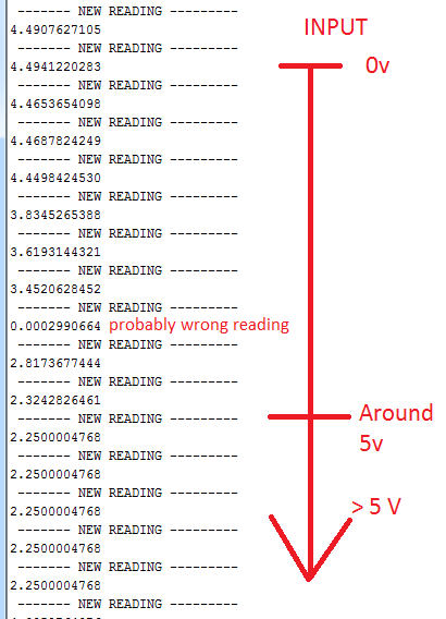

  • Something I noticed: Using a power supply, I noticed that my if increase the input voltage, my output voltage displayed in arduino actually decreases.
    Where is what I'm trying to say.
    I am not sure about this but I changed my conversion formula to:
    (4.5 - (channel[6]*(4.5/(16777215) ) ) )*2
    It kinda works now but I did this without actually thinking, that's why I will double check it
