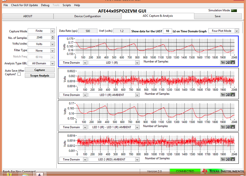

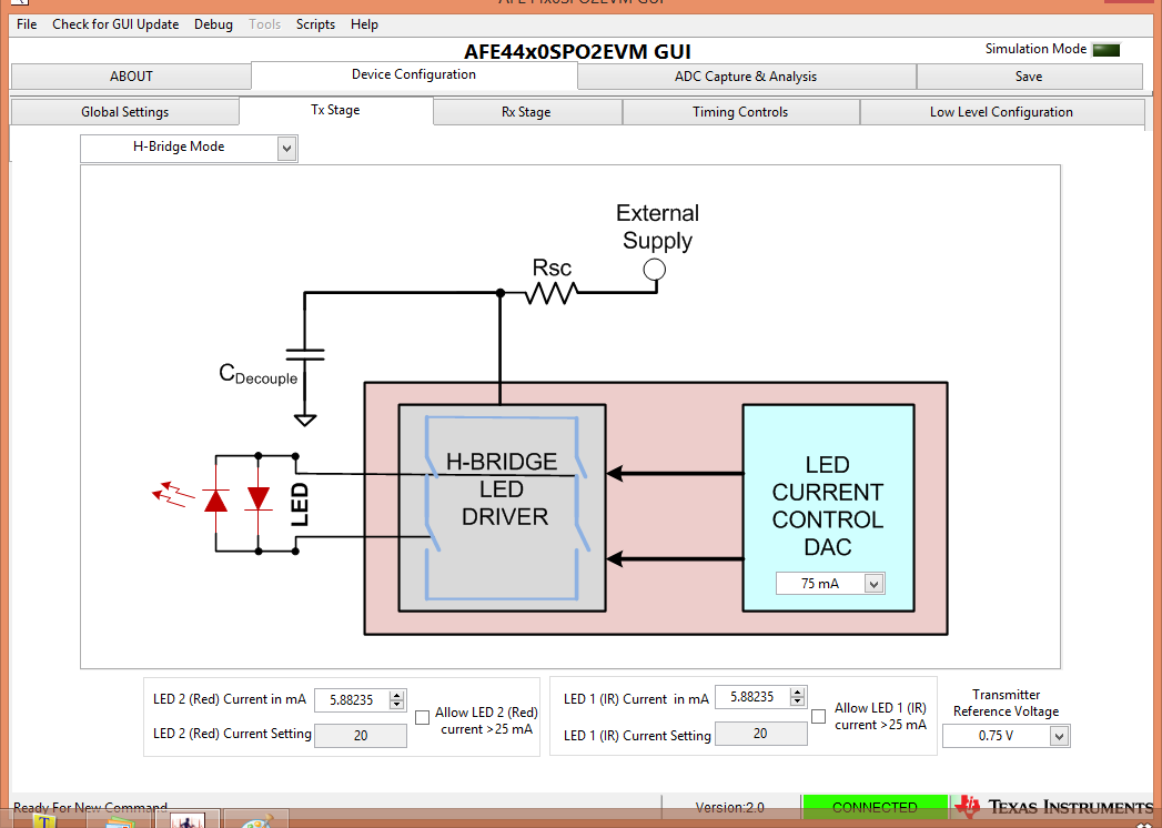

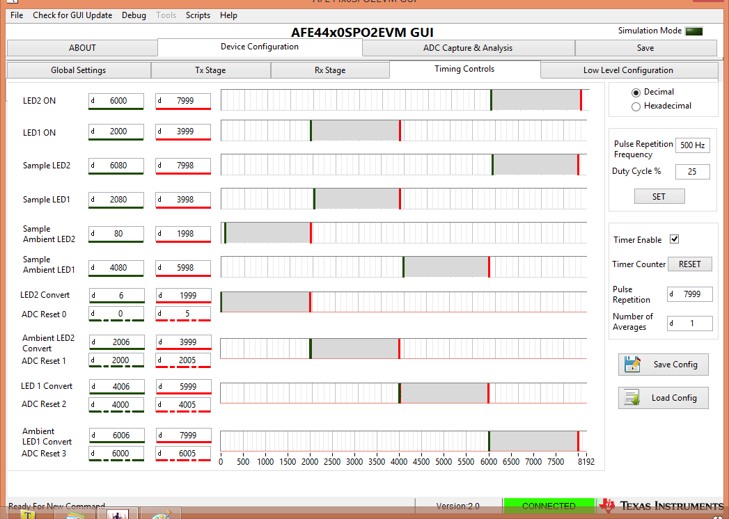

I am working on AFE4400SPO2EVM kit. I want to calculate Heart beat Rate. I will brief the settings done in GUI for this kit. I want to know whether my interpretation is correct or not.
According to above (LED1-LED1 Ambient) waveform data,
Samples between two peaks = 380
Sample Frequency = 500Hz.
So, time for 1 sample = 1/500Hz = 2mS.
So, time for 380 samples = 380 * 2mS = 760mS.
For calculating Heart Beat Rate,
60000mS/760mS = 78.94
Heart Beat Rate = 78.94
Please tell me whether my interpretation is correct and in order to acquire accuracy in readings which parameters to be altered.
