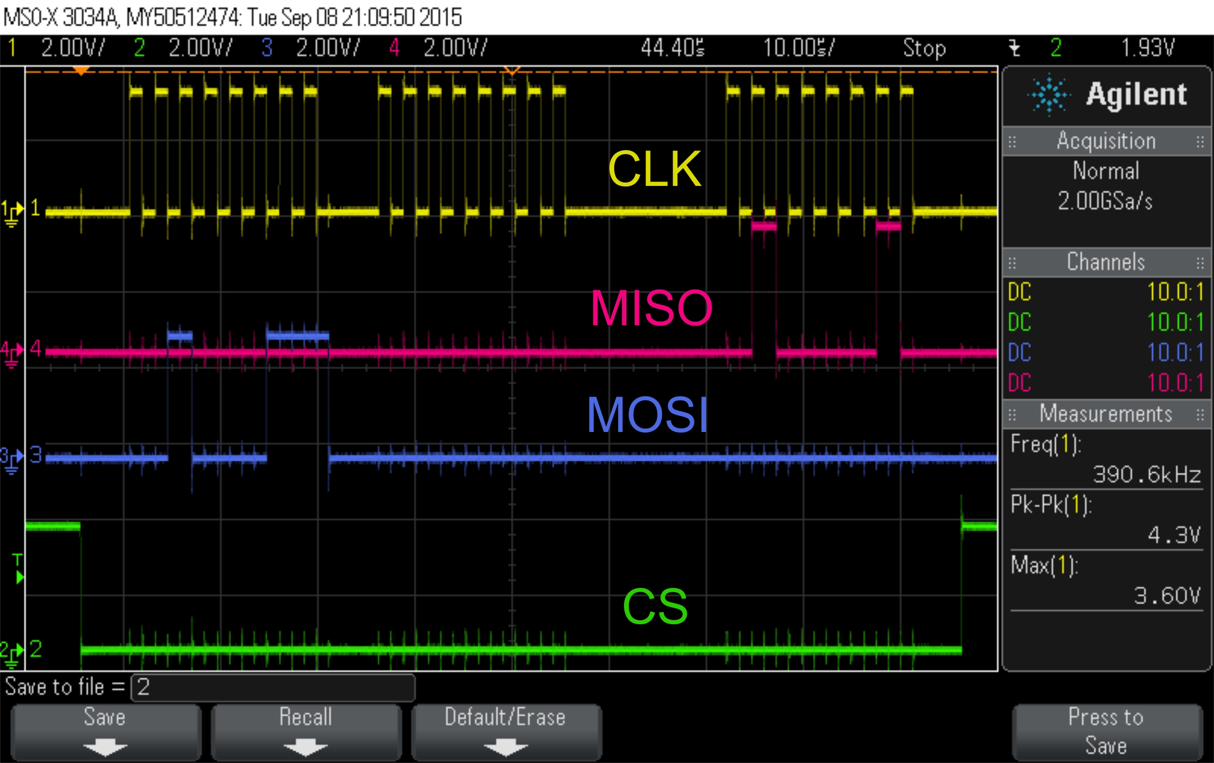

    Attached you can find an example of my SPI communication with ADS1247.
    In particular this communication  regards the read of one register at the address 0x03 (SYS0).
    My code is:
    CS_ADS1=0;
    while(DRDY_ADS1==1);
    WriteSPI(RREG|0x03); //read SYS0 register
    WriteSPI(0); // read one register
    __delay_us(10);
    ads_result=ReadSPI(); //ads1247 reply
    __delay_us(2);
    CS_ADS1=1;
    Thank you for your help,
    Michela
  • Michela,
    For input series resistance, I like to use 5k or less, but anything 10k or less should be fine. Actually, I saw the value on the schematic, but it didn't sink in for me.
    One problem that I see right now is that your MOSI is set up incorrectly, which means that you also might be reading it incorrectly. The SPI should be set up so that the SCLK idles low (which is correct now), and that the data is clocked in on the falling edge of SCLK. From the scope photo, it looks like the data is set up with the master thinking the data will be clocked out on the rising edge of SCLK.
    Check the code to makes sure how you have this set up. If the write to the device is set up wrong, then the read may be set up wrong as well. Once you have this checked, then take another data. Make sure you get the data read transaction on the scope as well. With the scope confirm that the data you read through the microcontroller matches what you see on the scope.

  • Hi Joseph,
    I don't think that there are problem on SPI bacause, for example, if I set a current value of 750 uA, I measure across Rref (1200 Ohm) a voltage of 1.8V (Vref=2*750uA*1200) that is correct.
    if I write incorrectly on ADS1247, I would not have measured this voltage... Right?

    I would like to also add a comment.  You may wish to verify that the data you are receiving is the actual data being sent from the ADS1247.  You can do this by monitoring the SCLK, DIN and DOUT signals with an oscilloscope or logic analyzer.  I suggest this as in each case you have given, when converting back to the hex value it is always showing the least significant byte as 0x00.  You may be incorrectly reading, shifting or interpreting the data.  Notice the values you have given in hex format:
    0x22F000
    0x22A300
    0x229500
    0x22B700
    These values would be highly unusual.
